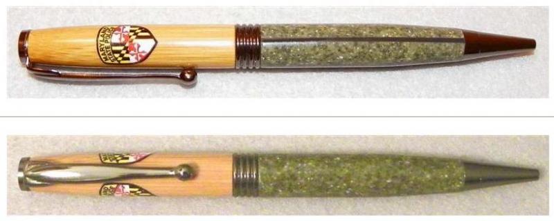

--- I use the same set up as Rick Roberts does (get my paper from decalpaper.com) and having very good luck, so far.
--- attached a picture of (two views of same pen) a pen I made for a retired Maryland State trooper.
Joe

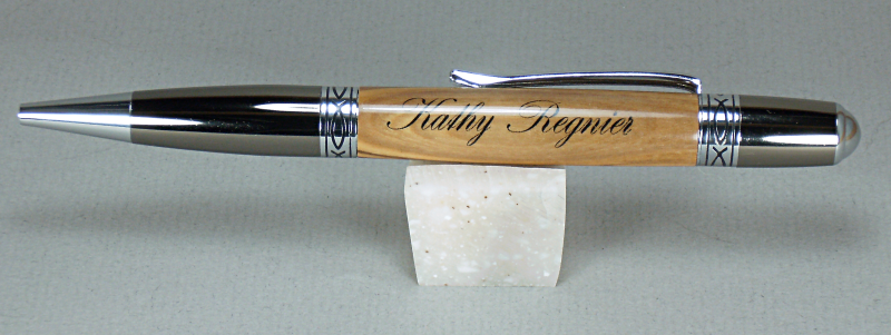

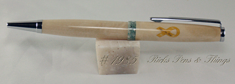

I have had good luck with lasertran paper. It's a waterslide decal and does not need the spray fixative. It's the only paper I could find locally and am reasonably happy with it.
http://www.lazertran.com/products/lazertran_products_inkjet.htm
Dries with a white background but oil based poly will make the background clear so the woodgrain will show through. I finish with several coats of CA.
A couple samples. The printing on the yellow label is clear enough to be read although small.
