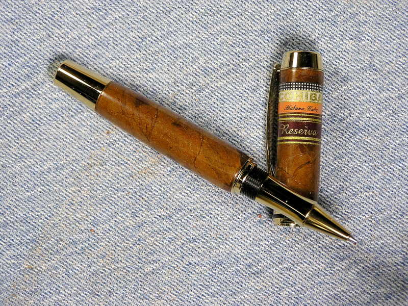

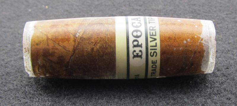

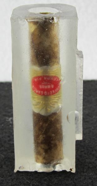

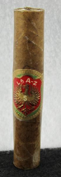

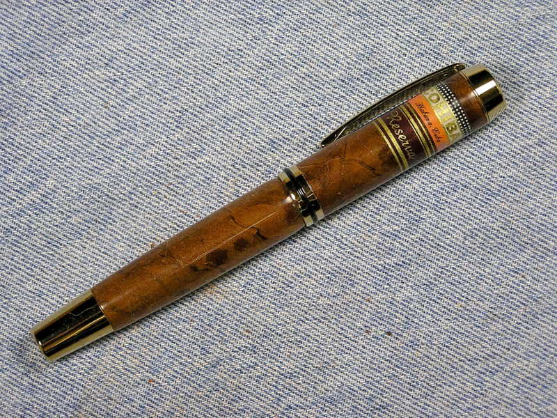

I have worked with tobacco leafs myself. There are several problems to overcome. First is moisture resin does not like moisture and Alumilite has an absolute zero tolerance for moisture you didn't mention what type of resin you where using I will assume a PR. So how do you wrap the leaf without moisture you can't they will just disintegrate. So I would wrap and glue glue them on the tube lately I have been using Mod Podge with paper mind you. But it has been working well I let that dry for at least 24 hrs. In your case though the tobacco is going to take considerably longer to dry. I would give at least 3 days in dry conditions maybe longer. Then for insurance and to help with the air bubbles put the dry uncast blank on the lathe and give it a CA finish. I use a medium CA and a plastic parts baggy. Wile the lathe is running slow put a couple drops on and smooth it out I do 2 coats it don't need to be smooth just sealing it. Let the CA cure at least 24 hrs. Now you cast with no worries. A lot of the air bubbles you are seeing may be leaking out from trapped air under the folds of a leaf. I had the same problem with air leaking out from under overlapped pieces of paper and the CA over coat solved that. Now I use finishing delrin bushings when applying the CA and the corner tip of a skew to cut/ score the end so it doesn't chip when removing the bushings.
Maybe that will help.
I believe there are 2 generic types of voids you can get while casting. One as described above is from dissolved gas either coming out of solution or forming as a reaction product. These can collect on the object being cast or seen in the middle of the clear resin. The pressure pot, degassing resin with ultrasonics, vibration or vacuum, poking with a pin etc are all valid methods to reduce these. The others is caused by the resin not wetting the embedded or cast around object. The latter are typically not as round as the first type but I have been fooled sometimes. These can be minimized by a combination of cleaning the object well, first soaking the material with resin (either catalyzed or not catalyzed) or in some cases "painting" with CA which I do with snake skin. A few experiments with some of these techniques should get you in a better place. In my experience, each material may have a unique procedure that works best for it.
