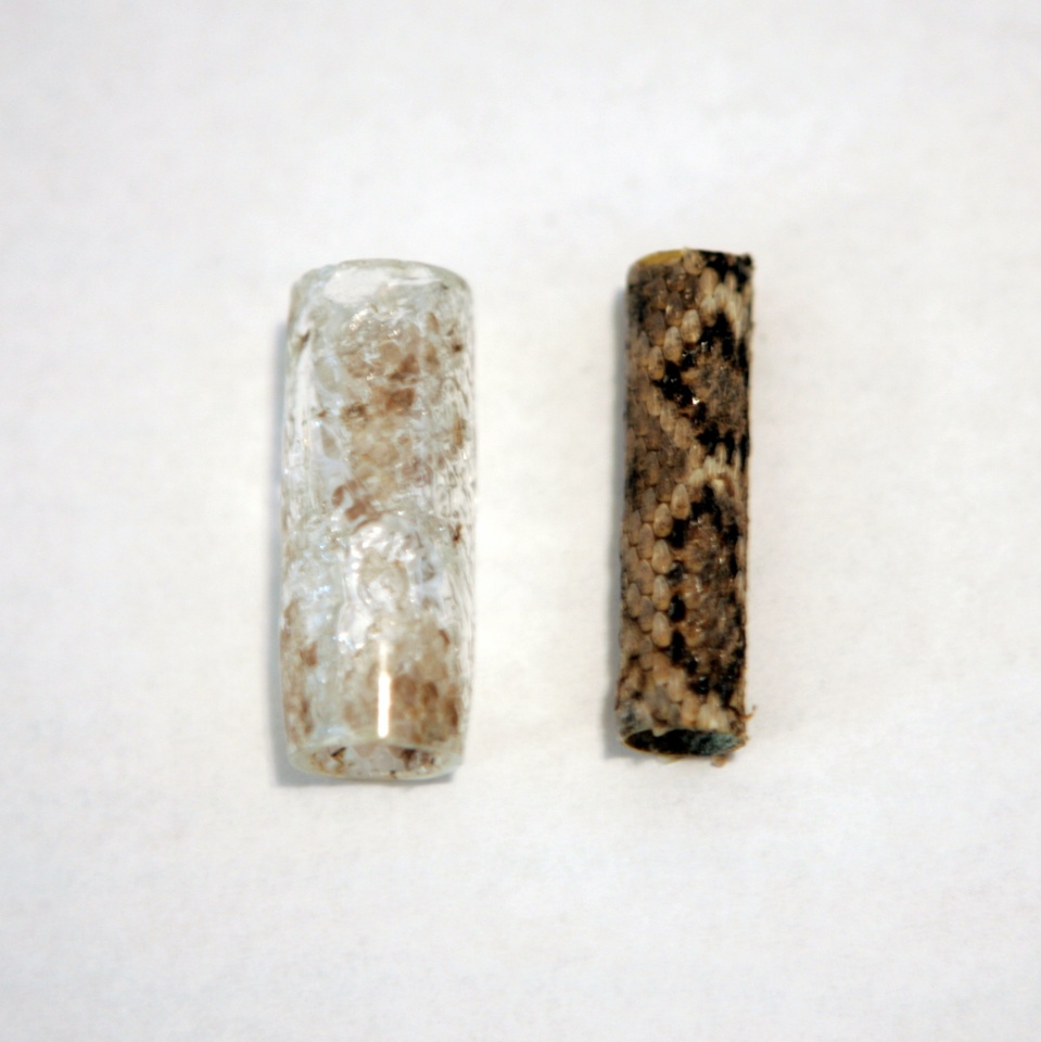

I am having a lot of trouble casting rattlesnake pen blanks. I am using the PSI casting kit and the resin separates from the skin when I cast it. I have tried a few different things to try to prevent it but keep getting the same result. After it drys, the skin looks shiny because it has separated from the resin. The tube with the skin easily comes out of the resin.
I would really appreciate some tips.

This is the skin that I pushed out of the resin.
I make sure there are no oils on the skins left over from the tanning process. I also heat (warm) my resin to remove any chances of air bubbles forming (so far I have not had to use any pressure or vacuum on skins)
Remove the scale covers prior to gluing to the tube. Clean the skin with acetone or lacquer thinner before or after gluing the skin to the tube. Try applying a coat of thin CA to the skin prior to casting and let it cure for a day before casting. To remove the scale covers watch this: https://www.youtube.com/watch?v=rNg8fajC9YI

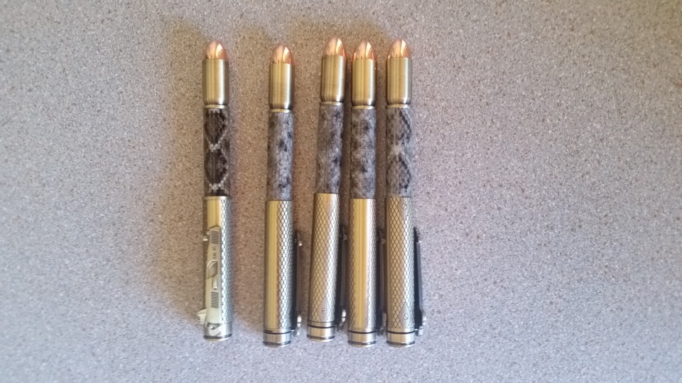

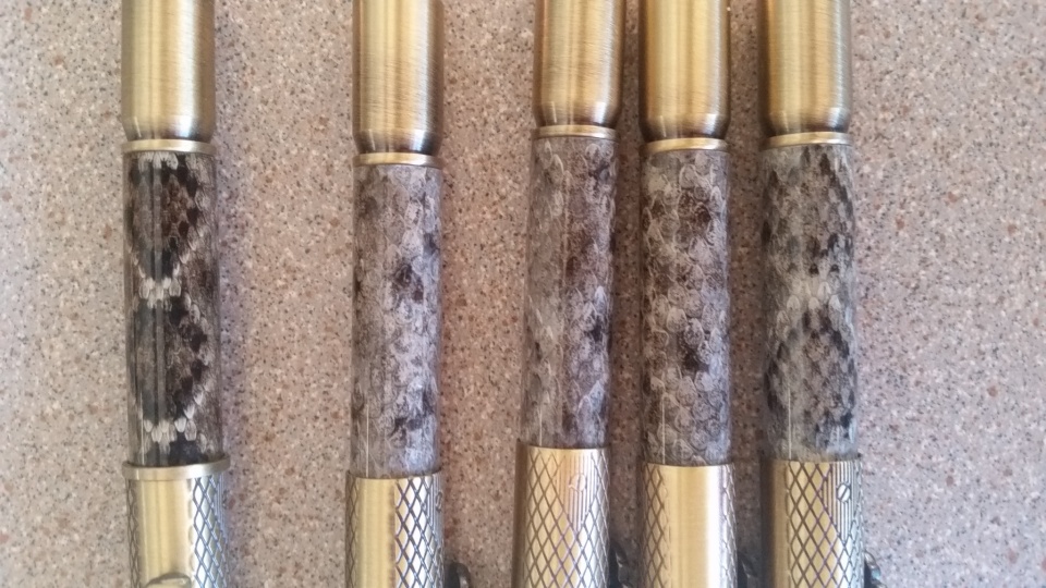

Well, they didn't turn out as well as I had hoped. The skins look very faded. This was either due to the skins not being as dark as I wanted or because removing the scales faded the pattern. You can see the pictures of them. The one that looks darker with a better pattern is the one I made last year (I have no idea why it turned out). All the others were the ones I finished recently.
Before I add my 2cents I need to say that some of those that already replied to your question helped me out quite a bit when I started casting. Therefore don't think I'm trying to tell you a better way just the things I've done a little different that "Worked For Me". First I switched to Denatured Alcohol because it seems to be less harsh. I noticed the acetone would bleach the colors if I let it soak too long. Second. When you paint your tubes before casting, you should if your not, the color you use can effect the final color of your skins as well. I use black occasionally, grey and the green used in camo. Good Luck.
Removing the scale covers did not affect the color or pattern of the skin. The pattern and color is in the scales which are part of the skin. Looking at the blanks (and skins) my opinion is the skins were from young snakes and the colors are not as vivid as with more mature snakes. The size of the diamond pattern makes me think they are from young snakes. Also, the skakes may have shed there skins just prior to their demise and the new skin did not have time to regain its coloring.
If you start using denatured alcohol you will need to allow the skin to dry before casting. Alcohol loves to take in water from the air. So, don't get in a hurry to to cast after cleaning the skin with alcohol.
Painting the tubes is a must. I use Rustoleum Camo in the flat dark green.
I don't think it is anything you did to make the skins look the way they do.
It also appears that all of the blanks on the new pens came from the same skin.
