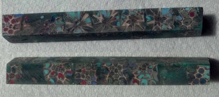

I do them 2 ways. One is making little blocks by sanding then flat as a cube, the other is cutting them in half on a saw, sand down the rounded side and resin the 2 side together to look like a yo-yo then clip most of the spikes and hand fill the voids with different colors. Very time intensive, but make great looking blanks.
Not the best pix, but all I had here at work...
