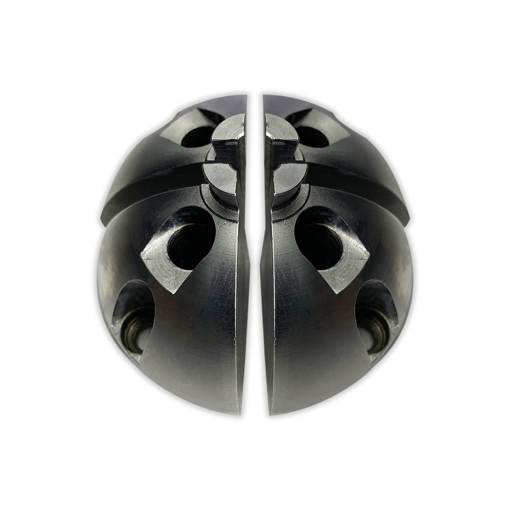

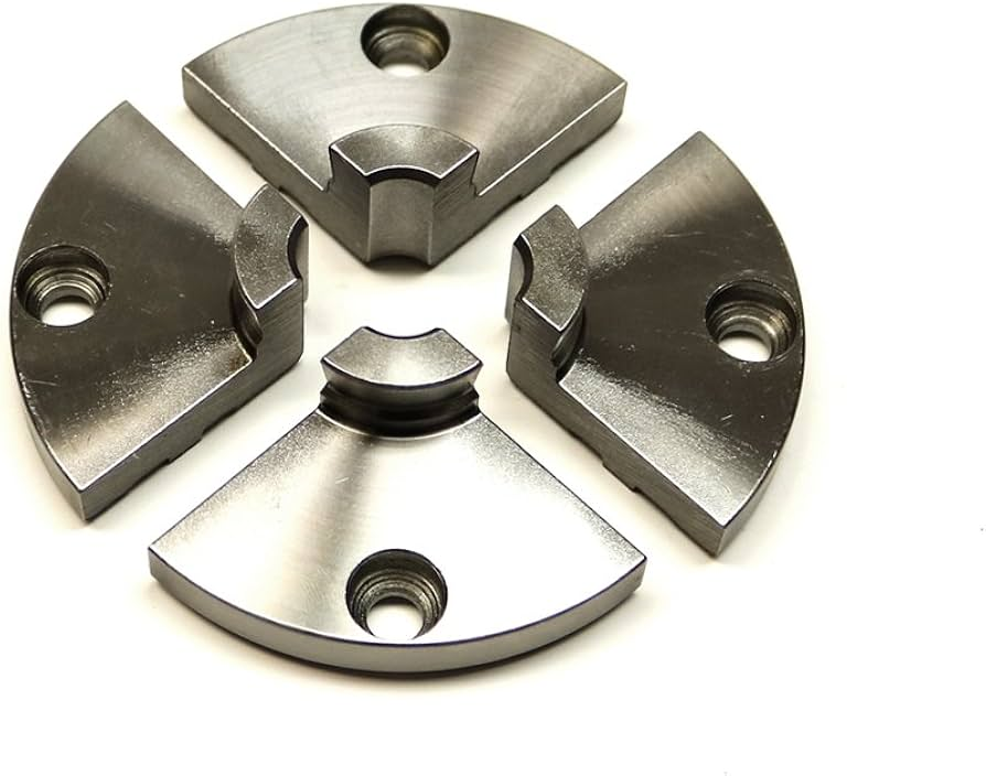

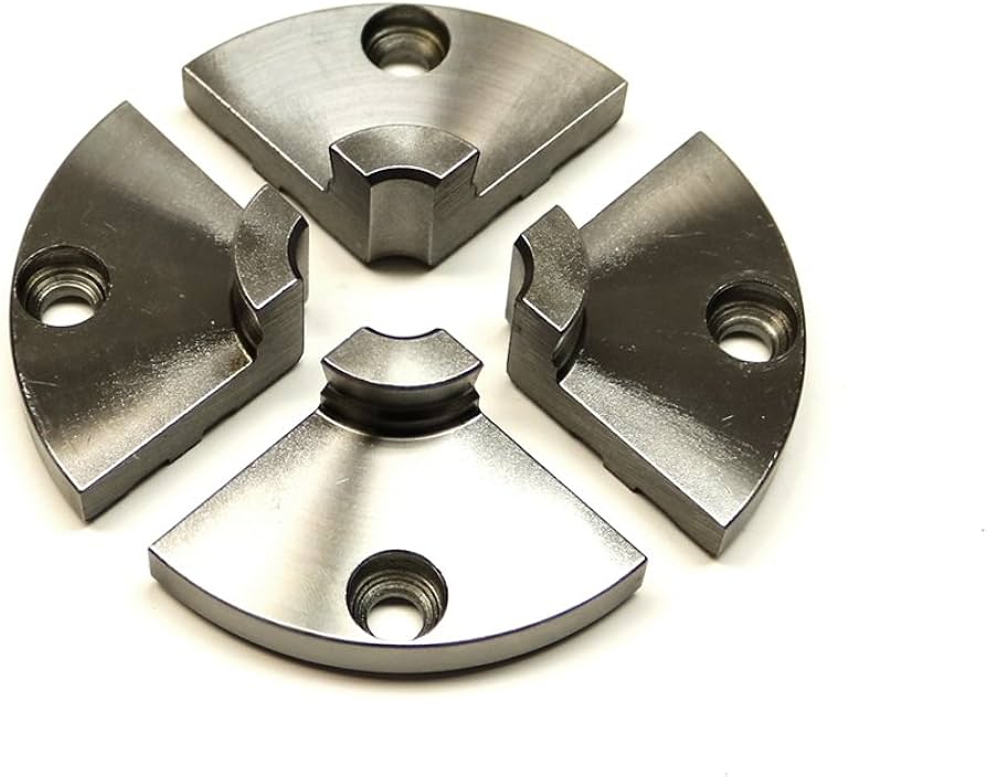

Does anyone know what the chuck with the 4 curved (inward) jaws is called? I see it used often by folks making nib holders, but am curious and unable to find them. I have no idea what they are called. I have a regular four jaw chuck, but it kind of scares me to use it.
I would guess the jaws curve inward so you can get close to the jaws to turn/part off.
Are you talking about Dovetail Jaws?
I'm looking for a chuck like this. What is this?

Nova has just brought out a variation of those dome jaws for their line of chucks. SKU 6091.

If you have a Record Power chuck, then it is compatible with Nova jaws. Generally speaking, though, most chucks have their own specs and the jaws of one brand are not compatible with another, unless explicitly specified.

Best way is to start by identifying the make and model of the chuck you own. Then go to the manufacturer's web site and look for their range of jaws (note that some have more than one chuck, and the jaws might not be interchangeable between their chuck models.)

Please educate me. How is this better?
I'm making an assumption here, that you are asking about the Dome Chuck specifically vs other types of chucks. Dome chucks are primarily designed to have a smooth, domed shape, so one can get their hands closer to the chuck without as much concern and risk of serious injury from bumping into sharp edges like one finds on typical chuck designs. - Dave

Yes,that's what I figured. I have a bit of apprehension about the commonly used four jaw. For fountain pen production I use a collet and feel very comfortable, I'm looking for something less scary to hold nib holders.

Thank you, good to know. I looked and my chuck set is a Pen State, but I'm considering a Beall set. I'll have to look into the chuck options though when considering a switch.

Better than what? Better than guessing whether a set of jaws that fits somebody else's chuck might fit mine?
As Hippie wrote after my post, their chuck is Penn State. I know of 2 different Penn State chuck/jaw types which are incompatible with each other, and both of them are incompatible with Nova, Oneway, Vicmarc, Record, Axminster, and EasyWoodTools chucks.

No, I was curious as to how these were better than standard jaw chucks. That question was answered. I'm used to working in close proximity to the chuck but can see how they would be safer.

As well as adding clearance for a tool to come into the workpiece from the headstock end, this type of jaw also permits gripping a tenon that's a lot smaller than other jaw types.
