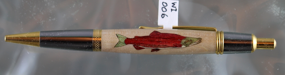

My posting this may be unnecessary, but ... just an example of one of my favorite Kallenshaan wood inlay blanks ... a salmon.
This one is designed for a Sierra twist, but I have put it on a Sierra click. . I think the dimensions would suit a Bolt Action, although on that pen kit the length of the salmon itself might be just a little bit on the long side because the Bolt Action blank requires a blank only about 2" long so the salmon tail and nose would be closer to the ends. . It would fit, but may look disproportionately long.
