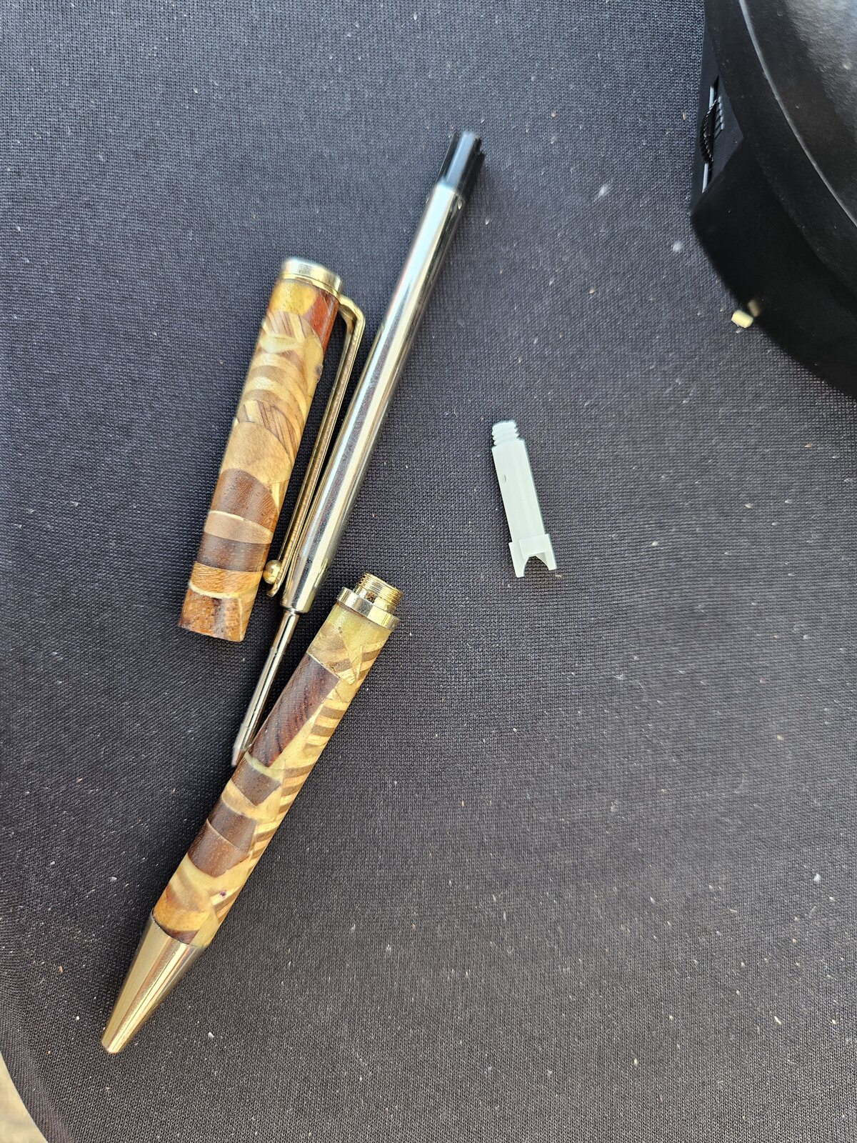

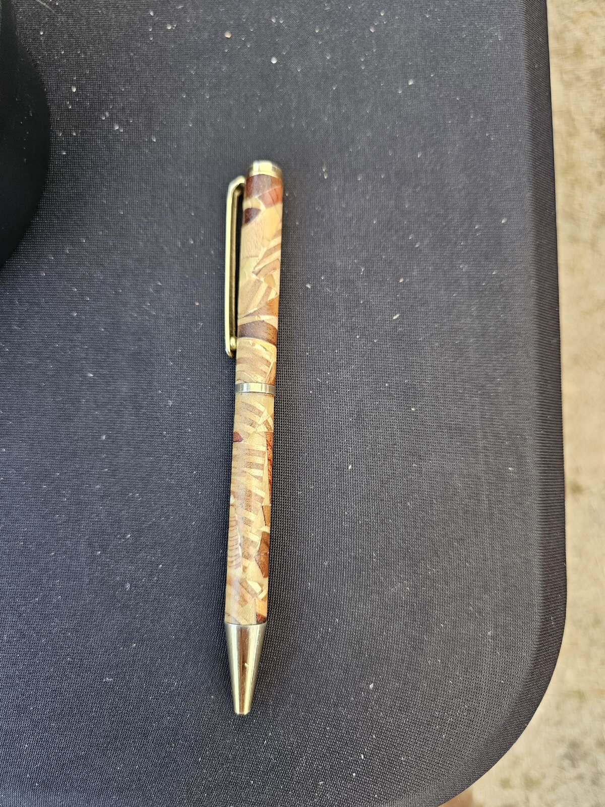

A lady came up to our booth this past weekend and asked if I could help her put her late daughters pen back together. Can you help me identify it. It is a click pen, looks like a slimline but uses parker ink.
Thank you in advance.

This is the closest I could find that is a click with a parker refill. The fact that the tip doesn't have the usual shoulder most slimlines I've seen is what makes me think it's this kit.
As a side note, that's an interesting blank. Very chaotic. Hopefully you can help this woman fix her daughter's pen so she has something more to remember her with.

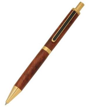

My first thought was the PSI Slimline Pro as it is a clicker that uses 8mm tubes and has a Parker style refill. The face of the clip would tell the story, but I can't see it in your pictures. The PSI has a black face on the clip. As Gregory (GFHWoodWerks) said, perhaps you can franken it. The tubes on the PSI are both 2-1/32" inch long.
