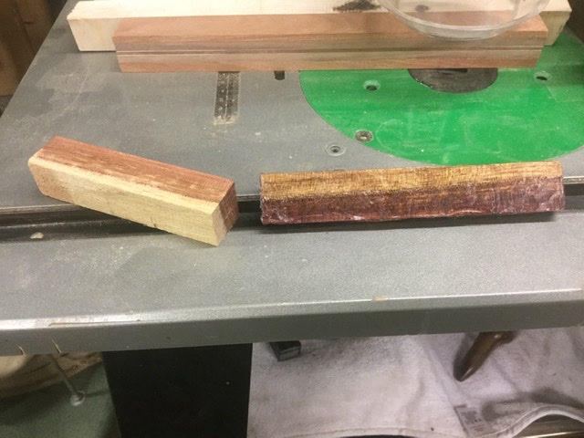

Just to add to the above. Stabilizing allows you to turn or indeed work woods with vast differences in density. You can have a wood with a very hard heartwood and soft sapwood yet the difference in say colour makes you want to turn a pen incorporating the areas the two meet.
So you cut your blank and then vacuum impregnate it then cook it to cure the resin. The softer sap wood is still ended by the resin stabilizing it and turns more easily as the piece is uniformly hard. This also makes the resulting pen more ding resistant as the softer area has been hardened. See attached photo, left hand piece of Bubinga is unstabilised , tight hand ( darker) bit is stablized. The left had bit you can dent the lighter sap wood with a fingernail. Not so the stabilised bit which is hard.
