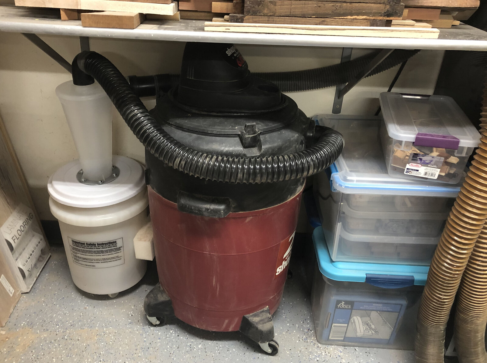

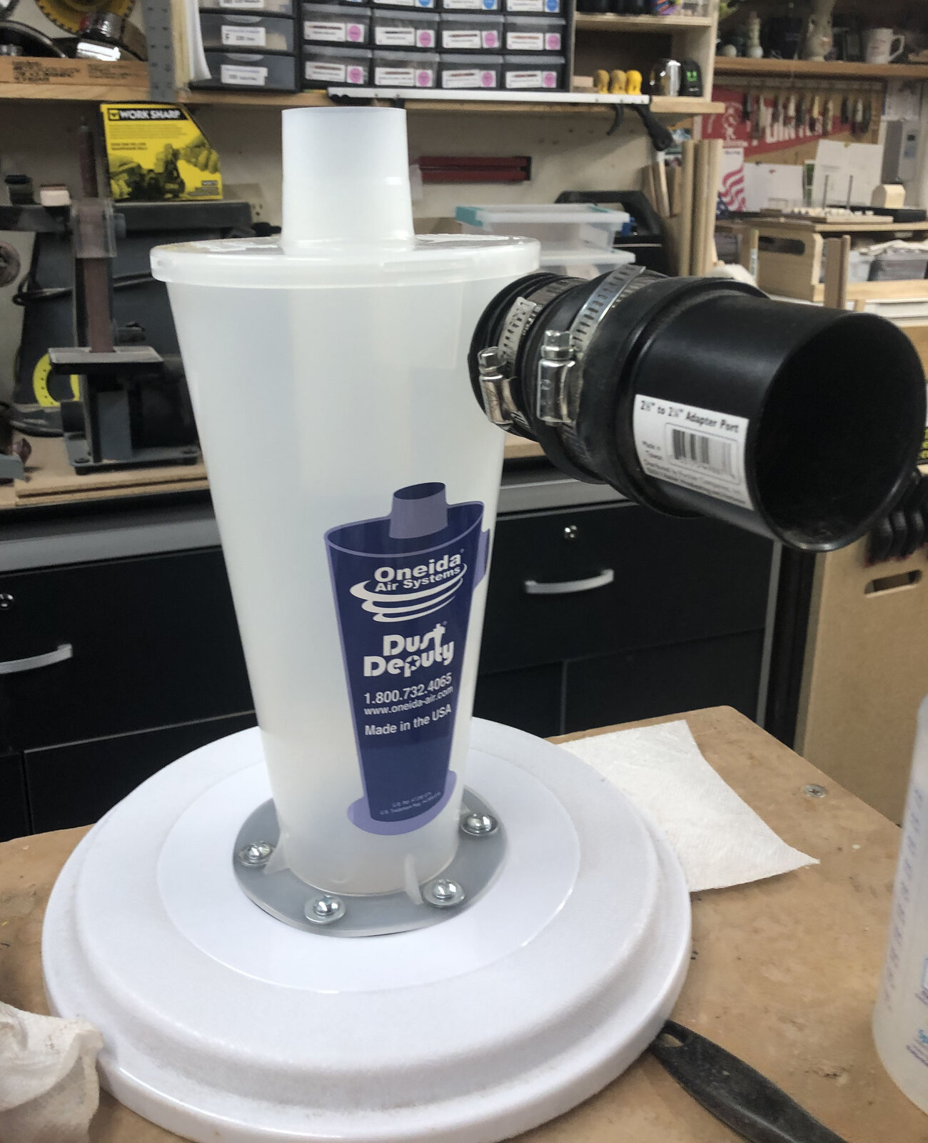

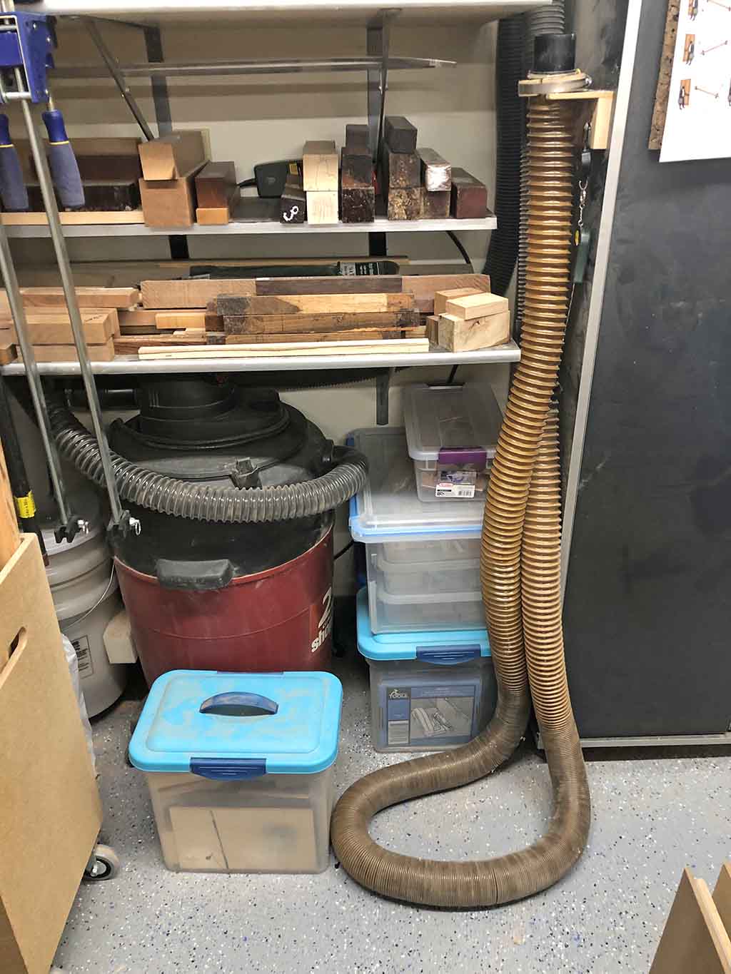

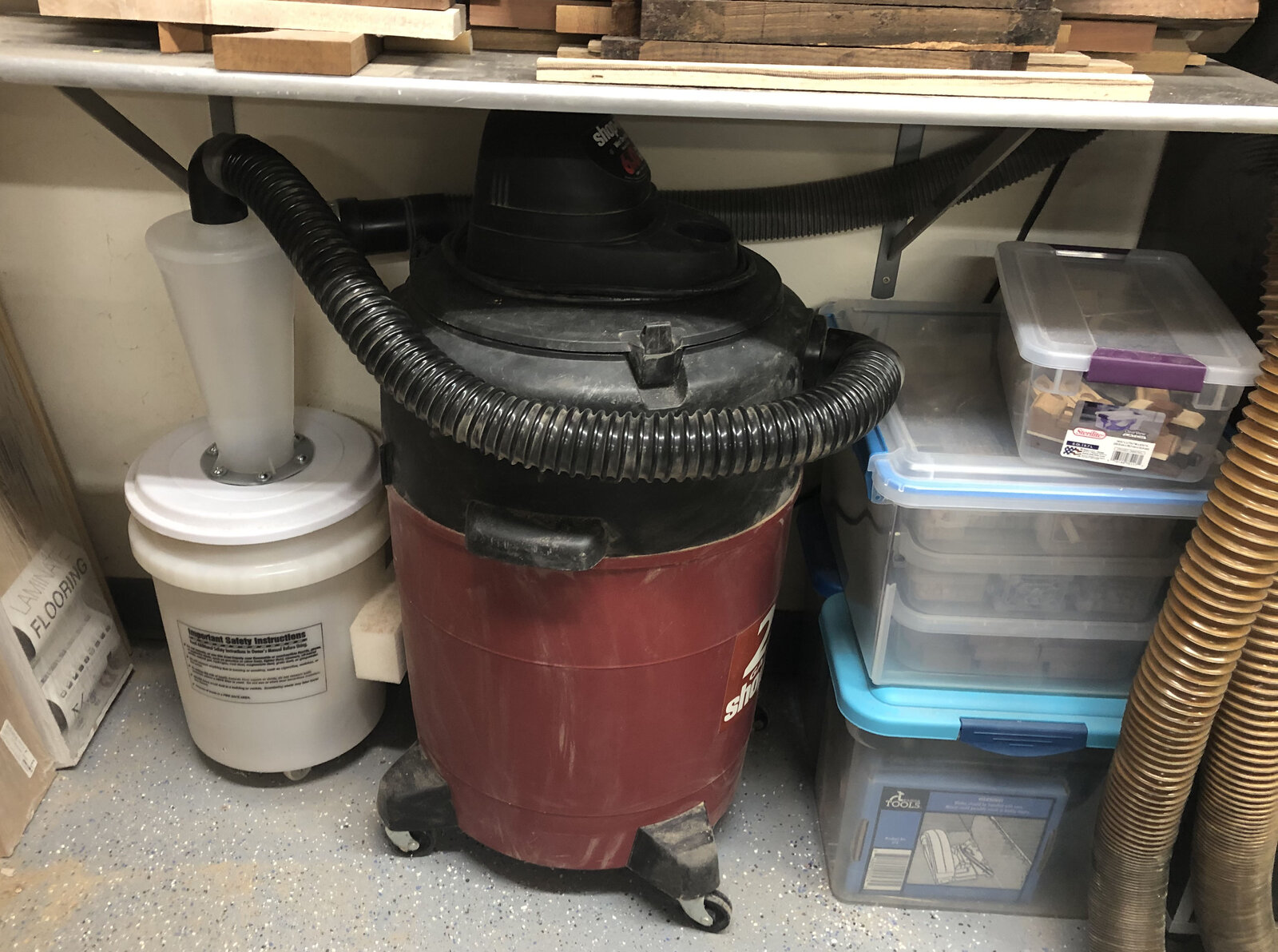

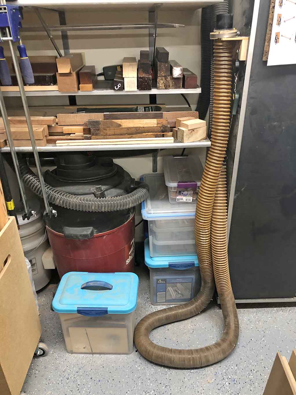

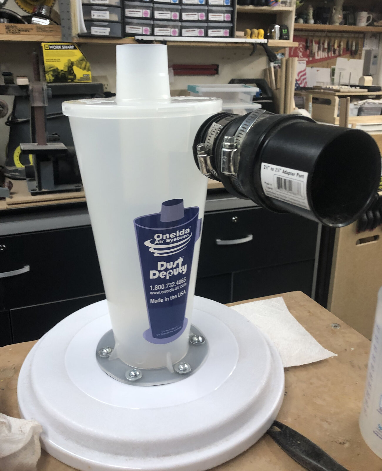

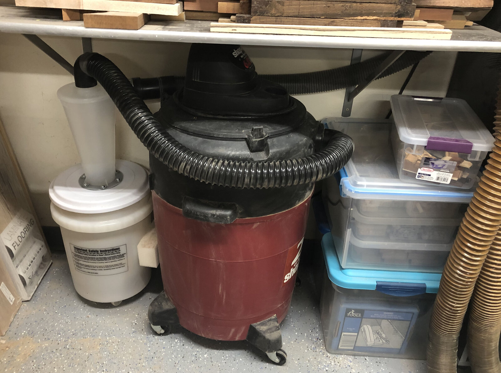

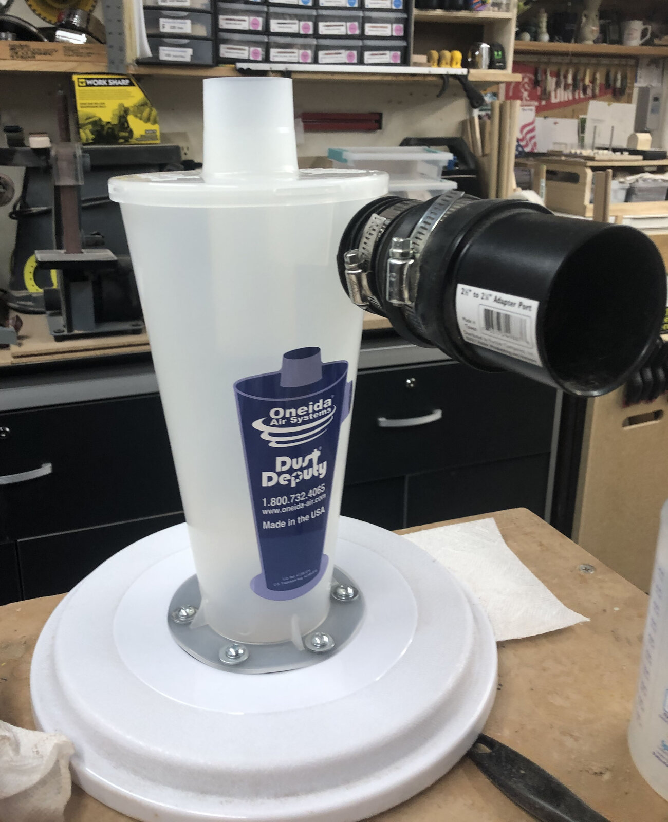

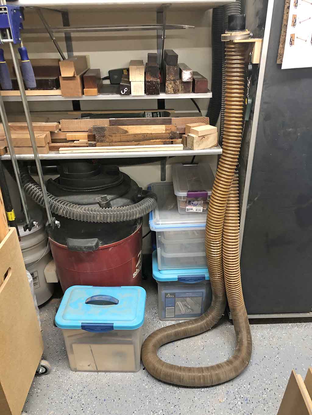

My shop is in a finished basement in our house. I use a rather large shop vac with a Dust Deputy separator inline and a scoop behind the lathe. It does a pretty good job of collecting true dust, but there are still a lot of chips that escape and land on my lathe, lathe table, and on the floor around it - maybe about half of the chips. I use the same vacuum hose, an extremely flexible and long hose, to suck them up afterwards. The Dust Deputy does a really good job of separating out the chips and any fines are captured in a bag in the vacuum cleaner that is designed for drywall sanding dust. Nothing really seems to escape from the shop into our family room even though I usually keep the door open.
Good Luck, I hope you find a workable solution and can enjoy the hobby. - Dave
PS Here are some snapshots of my setup. Click on the thumbnails to zoom in.
View attachment 380010 View attachment 380011 View attachment 380012
