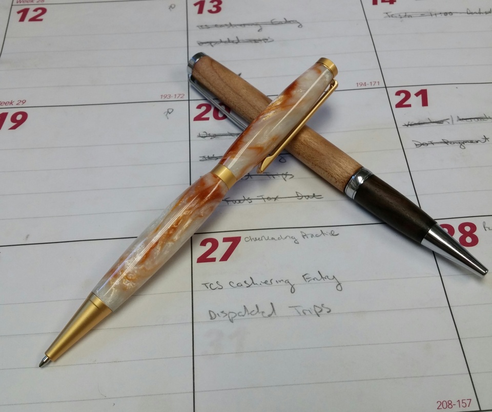

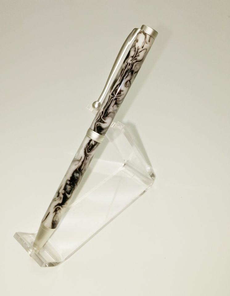

I have a process that using heat and convection currents to add some swirl to my PR blanks before it gels. Should I be using less MEK P?
I use the recommended amount, 6 or so drops per oz, and the pens turn ok but seem just a tad brittle.
Oh and I don't heat it up too much. Not like its smoking. I also now wear a respirator. Huge improvement in keeping brain cells alive. :)
