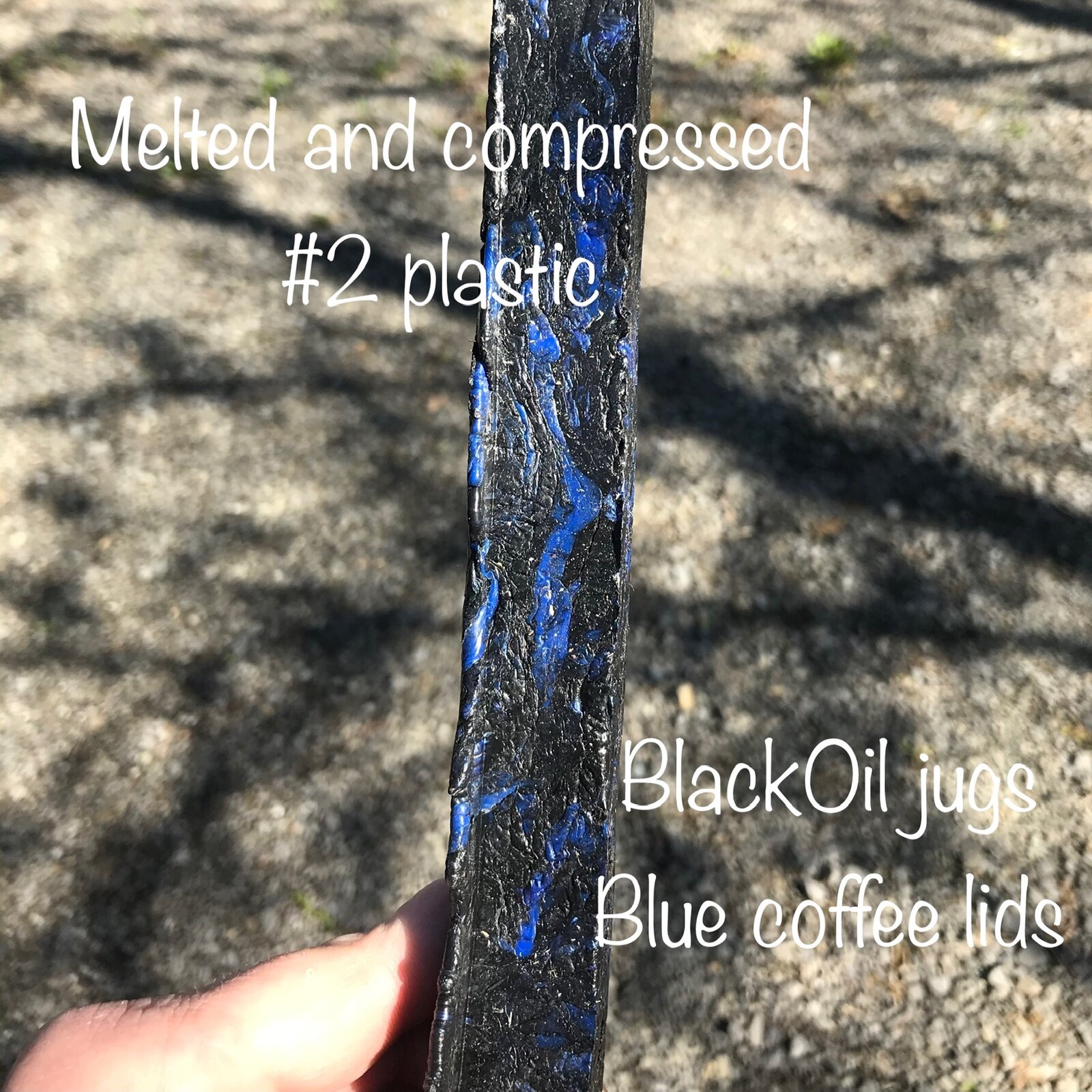

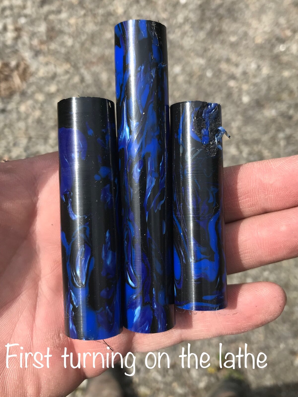

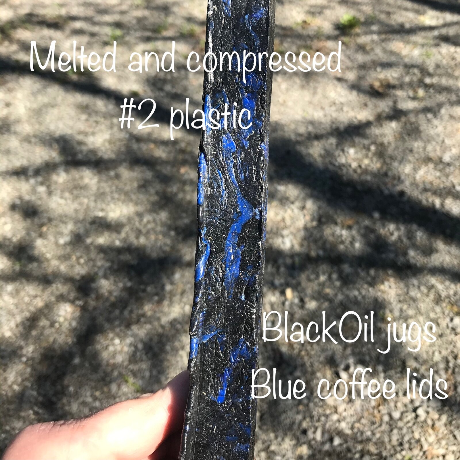

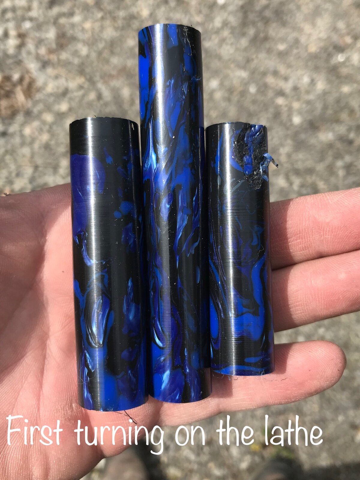

I am in the process of experimenting with this as well. As @Stubach mentioned above, Brothers Make on you tube have some great videos, it's where I got my start.
The temp should be around 150-175. I used a toaster oven the first time, but it is slower. I now have a panini press I picked up at a thrift store. It is quicker, but I am still experimenting with the technique.
My biggest stumbling block right now is the press. You need to press it really hard, and quickly. I am thinking about picking up an arbor press.
Another critical step is cleaning. Some of my failures, I am sure are due to some residual chemicals on the plastic, that my cleaning missed.
Keep in mind, this stuff does not thread well at all. I have not tried single point threading yet. I have read about a West System glue, that states in its directions that it can glue HDPE. I don't remember specifically which one right now.
Good luck on the journey.
