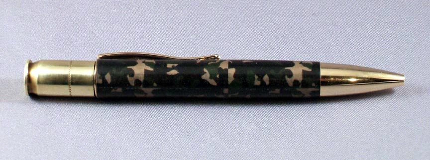

If you can find camo material with a small pattern it looks very nice. One of members of our local IAP chapter has made several of them. He just wrapped them around the tube with ca just like you do making a denim pen.

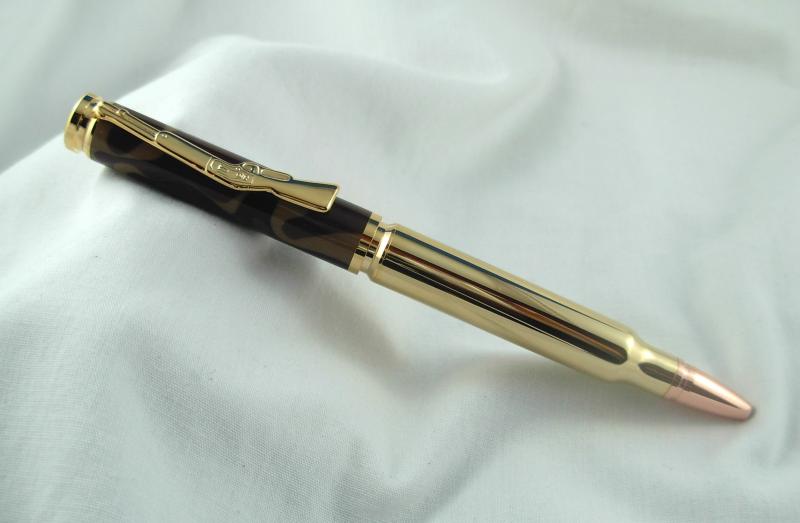

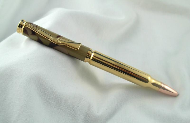

I get my acrylic camo from WilliamWoodWrite (Ontario). He ships worldwide and has excellent service. Sells two types - Camo and Desert Storm Camo.
My pictures don't show the camo too well. Sorry
www.penblanks.ca
Jeff
