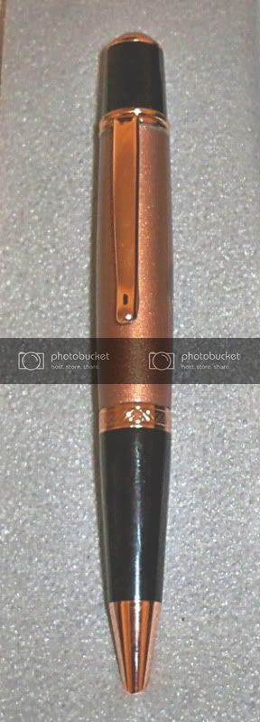

There are plenty of copper resin blanks out there. Yes it can be done if that is what you are asking and if you are looking for some just do a google search and you find woodcraft has some I also know Woodturningz has some. I do know a person who makes a great looking copper colored blank if interested I will get you the link.

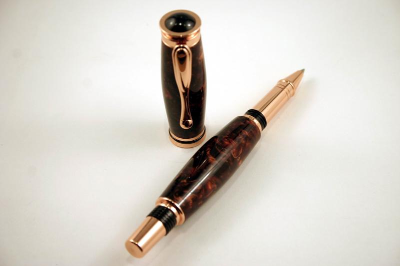

I actually casted some the other day. I used pearlex pigment and used copper but any mica powder pigment should work good. The cast looked real good I casted some Cholla and enough left over for a solid cast for a Sierra. It sure looks like a nice metallic copper. A little goes a long way the powder by it's self can be a little translucent so maybe add just a little more but be careful you add too much pigment and will effect your cure and the hardness of the resin. I would go with just enough so when you pull your stir stick out of the mix you can just see the stick through the layer of resin on the stick. Then afterward paint your tube a bright copper before gluing it in. That should work real good. But it will have a metallic look probably not a real flat solid copper metal look but I think it would look better. When I get a chance I will post a photo of the one I did the other day.

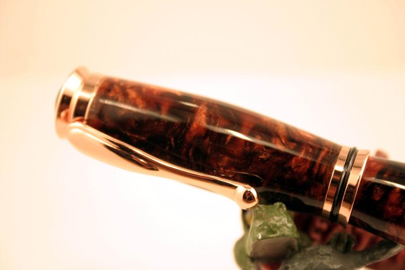

More than one way to skin a cat hehe,and if you are a cheapskate like me you can do something like this , simply a copper sprayed tube ,clear cast and finished . Looks solid but with depth hehe. cheers ~ John

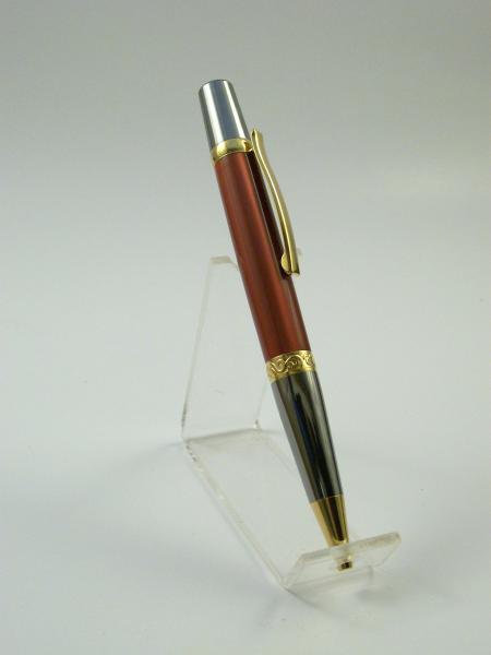

Try Douglas and Sturgess, I use their stuff and am VERY happy with it. Their copper is OUTSTANDING!
http://tinyurl.com/235cw97
They also have "tester sizes" for a couple bucks each if you don't need alot, a tester will do quite a few blanks.
Look under "Luster Pigments", they have every color you'll need.
