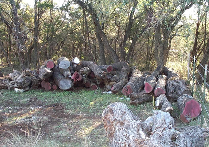

Here is part of my mesquite log stash. There is over 2,000 bf in this picture alone, (40,000+/- pen blanks!). All of these logs are over 4 years old with some of them 7. They all have the bark still on and some do not have the end painted. I have not really seen any difference in painting the ends or not. Mesquite heartwood WILL NOT ROT in normal cirsumstances. The sapwood will but that is all. Bugs will not really mess with the heart either. They might venture into it a little but not very far.
I also safely make pens and other turning with completely green mesquite right off the sawmill. I have had no problems at all with shrinkage. Mesquite is the most stable wood in the world according to Texas A&M University which makes it the perfect wood for turning finished pieces right away. No need to dry first.

I just love mesquite! Most of the logs in the picture will be cut into lumber on my sawmill to be made into flatwork for my house. The scraps will be saved for pen blanks! That is 2/3 of my stash! I got most of it when they widened a prominent road around here and all I had to do was show up with a trailer and a case of beer and the crew even loaded it for me! Oh yeah, did I mention that I love mesquite!
