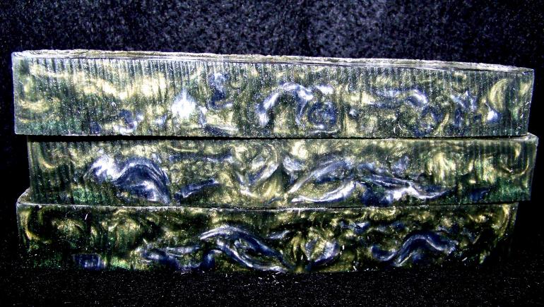

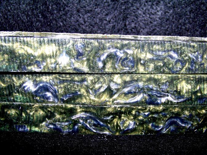

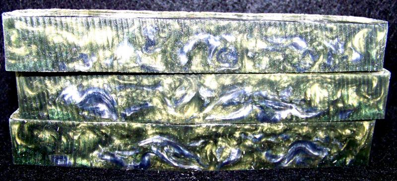

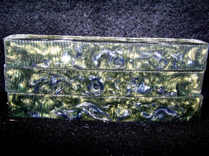

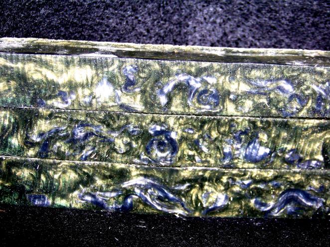

I made these the other day before I read your post. Would they work or were you wanting something different?

Those are fantastic color, but I just need it to be green & silver. I have to match this color. The silver is kind of dull or brushed color. I do like the way your looks with all the colors intertwined.
