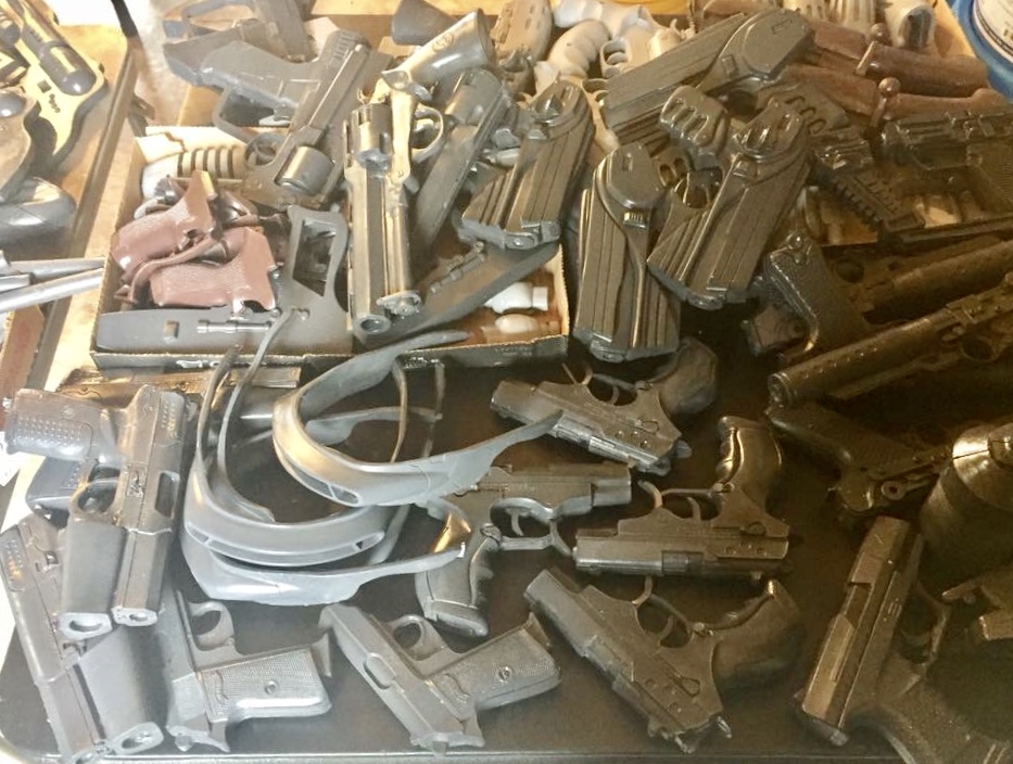

If you use Smooth On's Smooth Cast 300, which casts as solid white, all you'd have to do is add drops of the So Strong Black until you get to the desired shade. They are located in Macungie Pa, so might be close enough for you to drive out to.
If the picture loads properly you can see the color range ... White not pictured but everything else from pale grey to black.

I see it is also located in Walmarts. May have to look into this. Thanks:)
