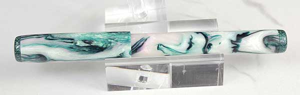

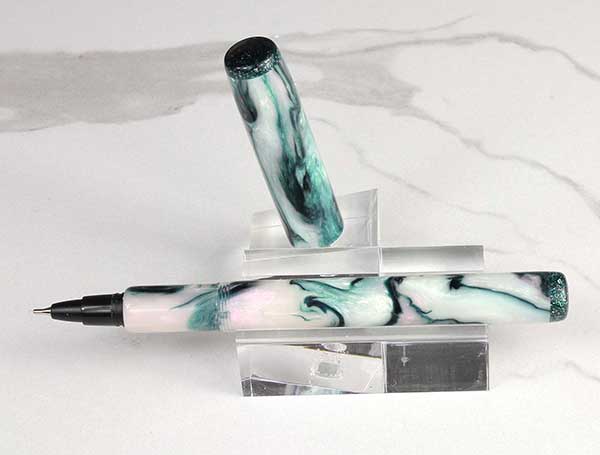

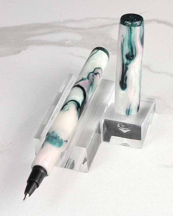

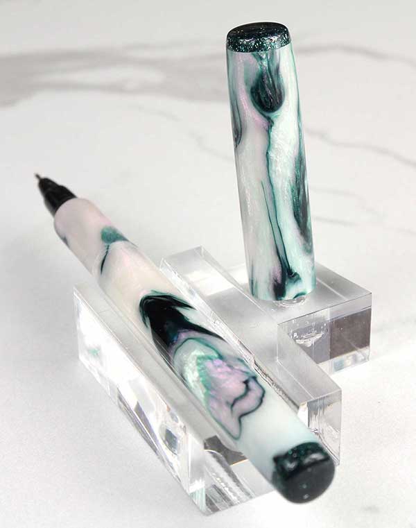

Getting closer to nailing all the sizes, pieces, parts.
Critique, comments, etc appreciated
Green Abalone Alumilite with DiamondCast accents.
PSI fiber tip
Cap: ~56mm long 14.3mm OD
Body: ~80mm long 11.8mm OD
Section: ~21.8mm long 10.9 OD
Total, capped length ~5,125"/130mm
Cap threads m12 x 0.75
Section threads m9.5 x 0.8 (3/8"x32tpi)
Fiber tip thread m7 x 0.75
