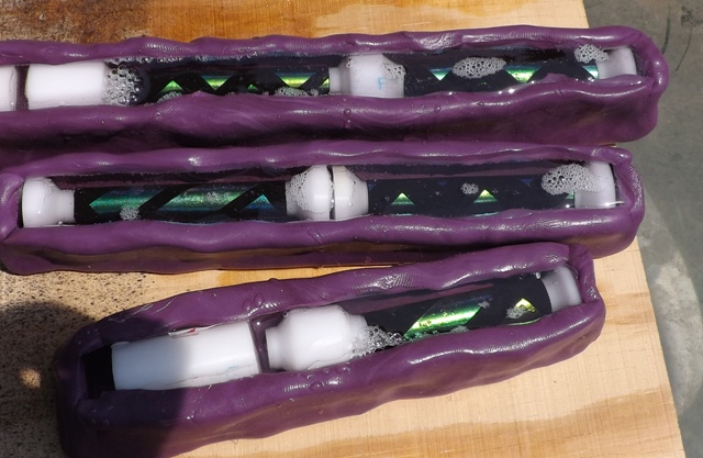

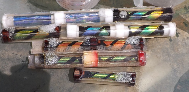

latest batch of Dichro curing. Got about another dozen or so to cast in the next few days. Wallstreets, Churchills, Tritons (which I was told is the same as the Atrax), Jrs and Barons. Need to make more stoppers.
tried casting a Black Chrome Baron tube without painting (all they had)... not happy with it. Think I'll paint the rest first.

Bubbles are the devil. I hope they are all surface bubbles.

The bubbles you see here are surface bubbles. If I catch them while still "wet" I pass a lighter over the surface to pop them (don't try with PR).
With the dichro, without pressure I do occasionally get a bubble stuck to something. I'm going to get a pressure pot to help eliminate that, but with glass they aren't as detracting (some of the fusing I do I encourage bubbles in the glass). Some of the other stuff I'm working on collect more bubbles due to the irregular surfaces. I won't be showing these until all the kinks are worked out.
