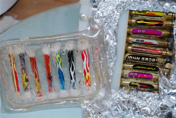

Here is the difference between using a pressure pot and not.
Fill the tubes with play dough leaving just enough room for the plugs in the end....no air inside to leak out. Have you been following the thread in the casting forum: No Bubbles casting?

Hmmmmmmmm, very interesting. I am going to give that some thought. In fact, I am going to try it. Same issue with the resin. One thing could fix it for both.
