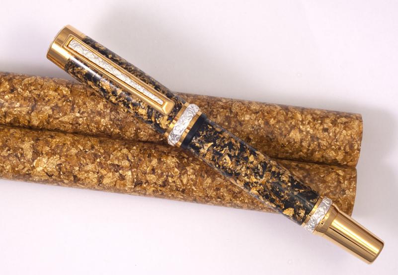

A customer is looking for something like this but wants gold leaf on a red background for a Noveau Scepter pen. Is there anybody that can do this for me? Thanks.
Resin saver mold or similar, resin from Michaels, gold leaf, and some paint. I did mine as a test and it was really easy to do. Give it a try! Warm the resin a bit first and it should resolve issues with bubbles. Paint the tube and seal it first and you can have any color without drill marks. Just my $0.02
