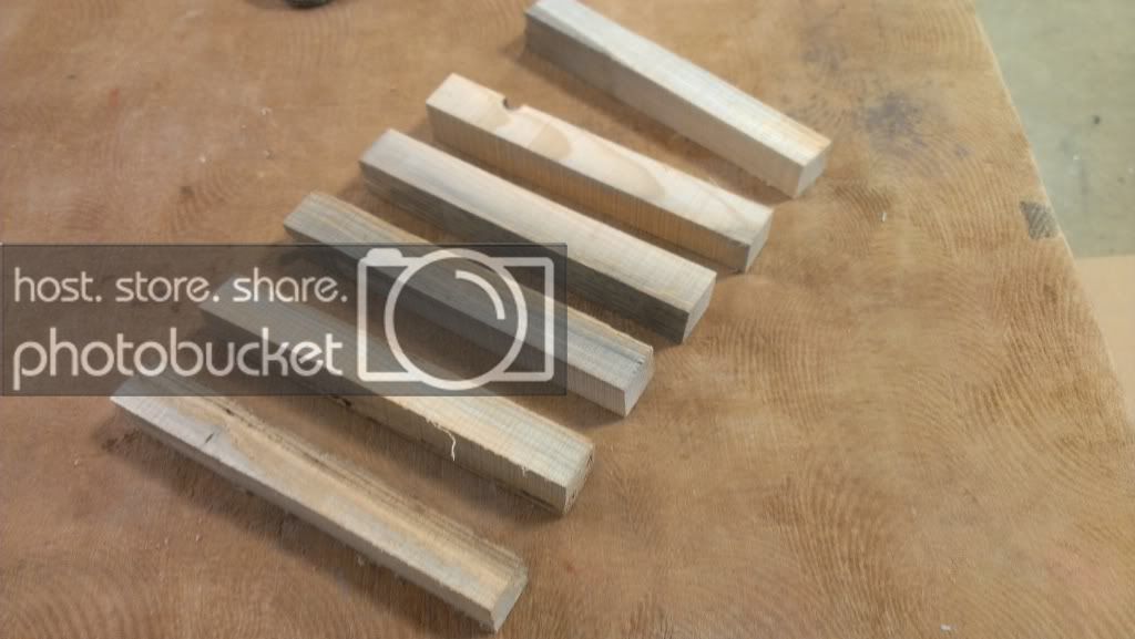

These are my blanks, not sure about the wood, I did look in the library for something on pressure stabilizing but I could only find vacuum info
The blanks are now just soaking in the Ronseal wet rot, I will see what they are like in a week or so, they are weighed down now but when they are full the shouldn't float any more, is this correct?
Not always. They may still float based on the specific graviy of the solution. Wet rot is about 30% solids so that's what will be left in the blank when the carrier evaporates out. Not quite enough to weigh it down.
