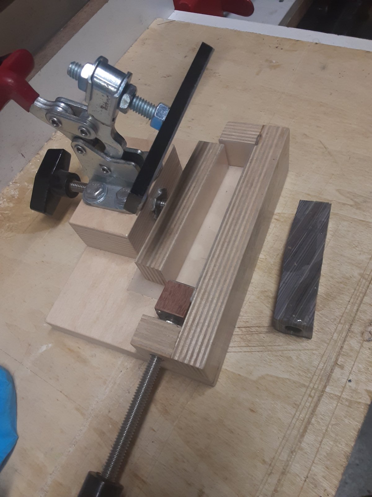

I'm starting to do some segmenting and I'm having a difficult time doing the glue-ups. I don't use CA glue so I don't get nearly instantaneous adhesion. I'll use either Titebond or epoxy. So when doing the glue-ups, the pieces are usually slip-sliding around until I can get them secured in clamps. Does anyone have a jig for glue-ups, or can suggest ways to simplify the process? Thanks.

Alot is going to depend on the type of segmenting you are doing. I always like to use square stock to begin with. Easier to clamp and keep straight when working with patterns. my jig is a simple piece of aluminum angle that you get at home centers. I place wax paper on it to prevent any glue sticking to it. That is simple to do. Just tape it on. Then I use a bunch of mini clamps or spring clamps. This way you can apply pressure just the right amount from all angles. Works well for me. Now I had to create a few other jigs over the years to accommodate different blanks.
