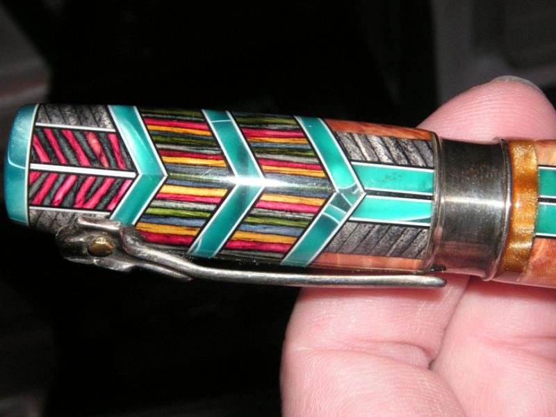

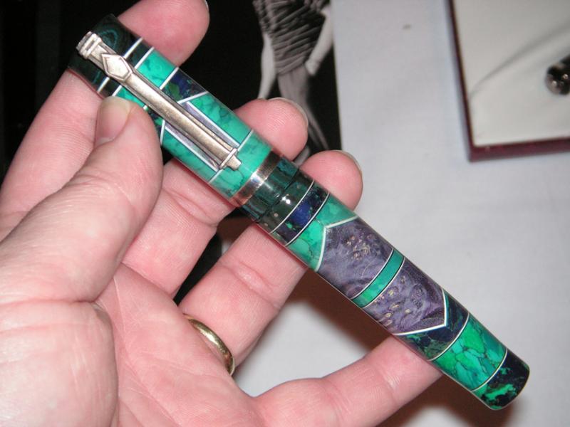

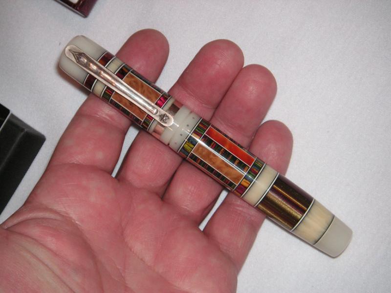

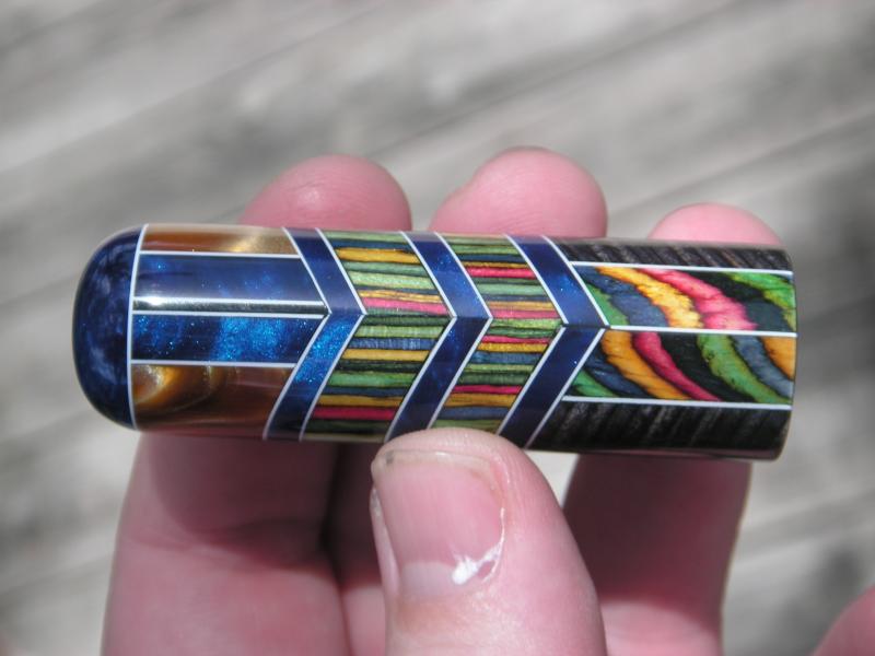

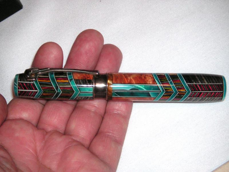

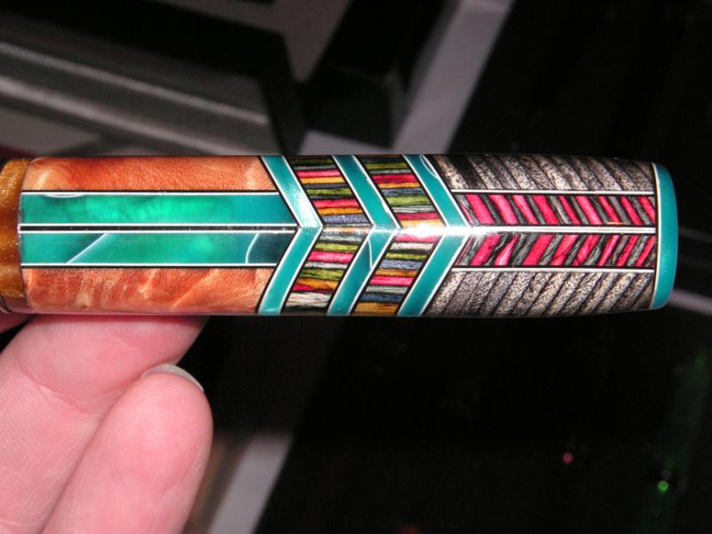

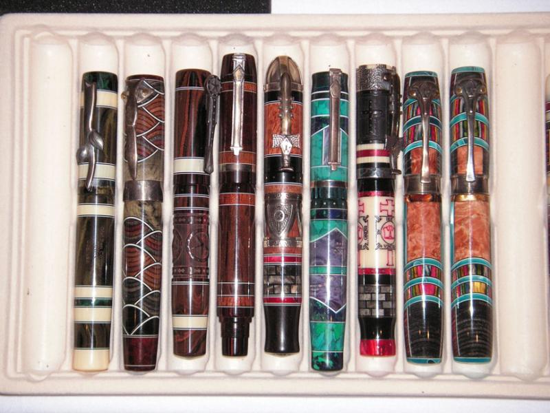

At the Dallas Pen Show last year, I stumbled across a very nice collection of Gisi pens for sale. Most were in the $400~$600 range, which had to do with the type of fountain pen nib on it (steel or 14k or 18k gold).

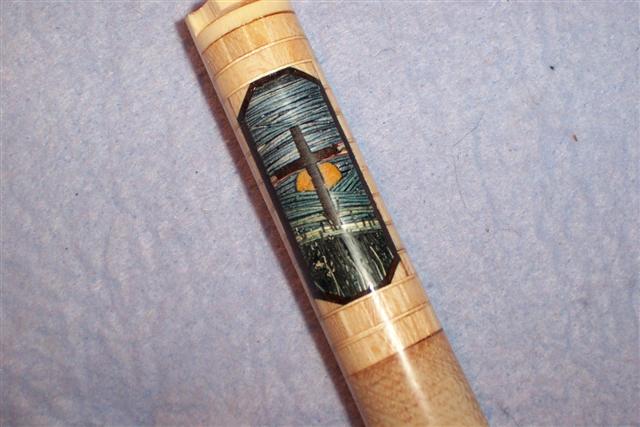

The "arts and crafts" pen (two of them are in the collection pic on the far right) are my favorite of the bunch, so I took a close up of it so I could duplicate it.
I'm posting these pics because I would love some of you more advanced segmenting pen makers to pick out features and describe how you think Gisi made the pen or how you'd go about making the same design.
My specific question are as follows:
1. In the Arts and Crafts pen, I thought he used dymondwood variants but I no longer think this because the end grain on them goes quite dark when finished with just about anything. Do you think he used dyed veneers and glued them up?
2. Some of the pens have little dots going all around the barrel. I'm thinking he used the indexing feature on his lathe to lock down the work and drill a small hole in the pen and drive a piece of aluminum rod (very small and thin) through it. Do you have a different thought on how it was done?
[Before you comment, I really do not care if you dislike the designs. I know they are busy and some IAP members have stated emphatically they don't care for the Gisi brothers' work. If they're not your taste or you don't have anything productive to add about their creation, please withhold your comments. I do like their designs and want to make similar pens for my collection and need help to learn how they made these pens! Thank you in advance!]

I think you're probably correct in your assumptions, either veeners or dymondwood, which is nothing but veneers anyway. And probably an indexing feature for drilling the holes and using a metal rod...
The first question. I am pretty sure they are dymond wood or spectraply or something like that. I have done pens in that style (obviously not near as good or polished but I have toyed with the process) and the dymond wood stuff looks similar.
Well let's see if Brian chips in any secrets. He might just lurk though... his trade secrets are indeed his trade secrets!
Thanks for that, Bruce. I used that tutorial last year and it was really helpful. How he made the pen I shot closeups of is a totally different level of work though, huh?
Almost forgot to share something that kinda set me back when I stumbled upon the pens at the show...
These are not one of a kind pens. He produced numerous pens of the same design. I'm betting he was able to cut down his per-pen time considerably by making many at a time.

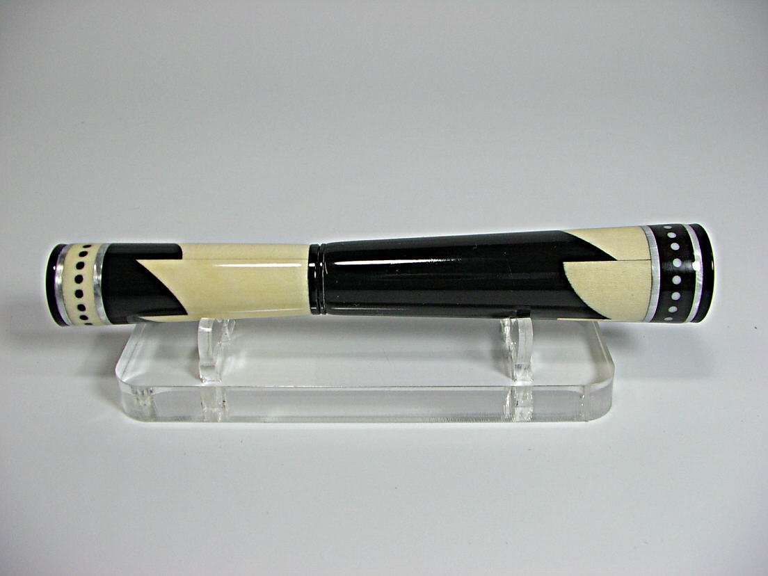

1.) They use the statabond material that CSUSA sells. This is the all black layered material (comes in brown as well). The other stuff is called Color Grain and it is from PSI. It comes in a variety of color combos and does not darken when finished.

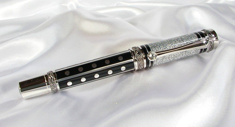

2.) The dots are sterling silver wire. You could use aluminum as a substitute. I would guess they use an indexing plate to get equal spacing. I was able to do the same thing without an index plate by shaping my material into an octagon and then drilling at the drill press on each side and then gluing in the material. Of course this only gave me 8 dots.
They do all their own silver casting for the clips and bands. The clip is bolted to the upper barrel using very tiny model railroad bolts. I was able to replicate this with some scarp brass and it holds very well.
I think they do an excellent job of combining different woods and resins together but it is the precision of their joinery that amazes me!

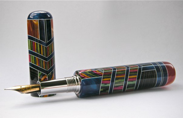

Here it is sans a clip! I didn't nail all the chevrons where they come to a point, but I noticed Gisi didn't either, so I don't feel too bad :smile:
The color in the second close up of the cap is closer to the actual color, but neither really do the pen justice.
BTW, this is one FAT desk pen. A majestic kit is quite small next to it, believe it or not...

Excellent work!
It is no small feat to get all the points to line up and drill the blank down the center of the pattern, I think you did an awesome job with it. Are you keeping for yourself or selling it?
I can't wait to see it with the clip on! I bet you are already losing sleep over drilling holes in it to bolt it on.
Wonderful, lots of hours in that pen. I like the swirl effects on the laminated dymond wood.
Hebertjo turned me on to the fact that Gisi used "color grain" instead of dymondwood so I went with that instead, and I'm glad I did. Dymond wood is not nearly as good a product and darkens with CA glue finishes when cut at certain angles AND cracks!
I initially bought "super blanks" from PSI of this stuff and it wasn't super sized at all, so I bought bottle stopper blanks and cut that up. Then I discovered the red and black striped laminate that Gisi used is not available, so I swapped it out for more of of the color grain with a different cut. I took the two skinny pen blanks, glued them together, and sliced them up into strips.
Curious about the application of the silver wire - how do they turn it after inserting ? Doesn't it eat away at the tool ?
Not really. Silver is pretty soft. I used aluminum and it dulls tools some as with any metals would. But nothing that outstanding. I have also used arylic when doing dots. ..
