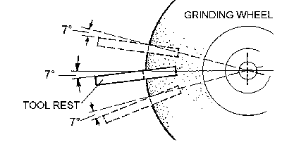

This might be a strange question to ask? It is something that gives me trouble every time i go to sharpen my tools.
What is the best way to set the required angle on a jig platform table???? You will think this a silly question, but i find when using angles my brain will not grasp this simple task!!!!
If i need to sharpen say a roughing out gouge and i needed to find an angle of 45 how will i find this?.[:I]:D[:o)]
Dermot, this sketch show how to set and angle. This one shows 7deg but just change it for the angle you want. If you have a line coming from the centre of the wheel extending outwards, you simply set the angle to this line as it goes past the edge of the wheel. The drawing shows that you can have the line anywhere. If you want 45deg, then you would want the line quite high on the wheel.
