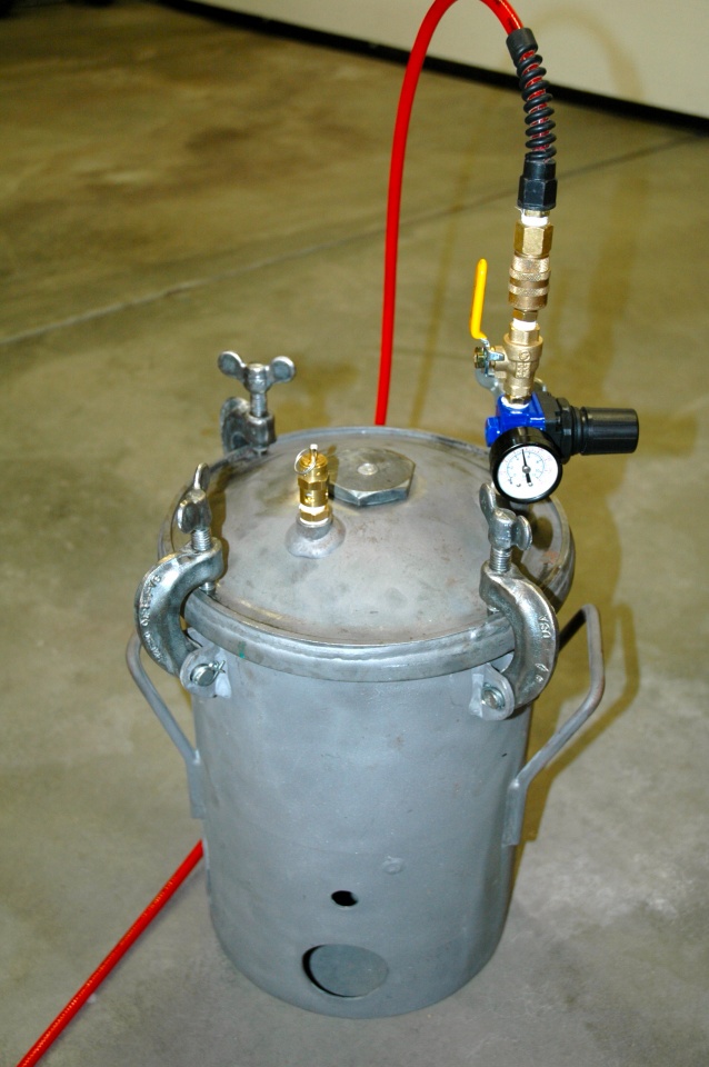

Just my .02¢…Start with Alumilite clear, order some of their dyes, especially the primary colors. The HF pressure pot is a gamble with your life when you get past 40psi in my opinion. You're better off finding an American made pot, i.e., Binks, LaGrange, Devillblis, Graco. Get something that is ASME Certified. Your life is worth a lot more than the couple hundred bucks you're saving by purchasing the Chinese crap. I found a good solid pot, made in the USA, ASME Certifed up to 125psi on Ebay for $60.00. Yes it was dirty, but I had it sandblasted, paid a visit to my local paint shop who helped me modify and retro fit it with the proper valves and safety release valve (all American made) and it works like a charm. Go read Curtis Seebecks adventures in HF pressure pots here...http://www.penturners.org/forum/f43...ot-failure-my-wife-almost-became-widow-51588/ It will make you think long and hard about saving a few bucks. Don't do it!

Thanks for all the advice...you have officially scared me off of the HF pot. I manage a welding shop and we do a lot of work on pressure vessels (big ones....30k gal and up) so I unfortunately don't have anything small to get from there. What I will do though is put that HF pot through the wringer of tests to make sure it will do what they say it will do...probably will even fab up some kind of safety bar to lock over the top of the pot lid. I did search craigslist and ebay for a Binks and found a few prospects so I'll be picking up one of them to be sure.

I think everything has been addressed above but I wanted to add ... In regards to pressure tanks, make sure you use them to their specifications. Inspect them regularly to make sure they are in proper working order ( seal, clamps, gauges, etc). Work in an area away from others, and if you see a problem with it, fix or replace it. Don't press your luck. For what it's worth, I've been casting for years and make thousands of blanks a year. I've only ever used HF pots and never had an issue. Be safe and keep it fun!

Dont get too scared off by the thread about Curtis' pot. He will be the first to admit that his failed because of modifications that he made to the lid of the pot where the clamps hold the pot on. These modifications caused one of the clamps to fail and, therefore, the lid to fail.
Many of us, me included, have been casting fusing a HF pot for years with absolutely no issues. The key to success with any pressure pot is to ensure that you are using safe pressures for the pot and to ensure that you are using good practices when using the pot to ensure that the clamps are always tightened down appropriately. Remember that your primary goal when casting under pressure is to collapse the air bubbles. You don't need high pressures to do this.
