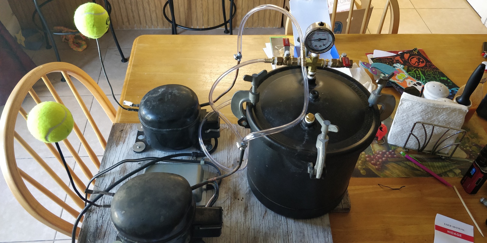

Hello all!

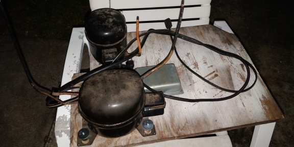

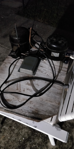

I started to get her the supplies to stabilize a few weeks ago. Found a pressure pot for $30 (yay). Got a bunch of pen blanks in that would benefit from stabilizing. And today I found 2 free mini fridges that still had working compressors! Got them on a board and will eventually get the fittings I need and cactus juice over the next few weeks. Can't wait to get my system setup.
Sorry pics are garbage. Ill take better ones in the AM
Sent from my ONEPLUS A5010 using Tapatalk
Not sure about a pressure pot but I've used CJ in a vacuum pot, not a pressure pot. My vacuum system always looks and turns out great.
I plan on using the bottom half of the pressure pot and getting a acrylic lid with a seal for the top. Trying to make a vacuum and pressure system and trying to save money doing it
It is my understanding that CJ will break down acrylic after a time. Be careful.
I read that as well. But I do need to somehow view the inside so the bubbles don't get into my vacuum line. So to help save a bit of money I am using just the pressure pot lid and to view the inside I have a wireless camera. Got the camera for $28.
