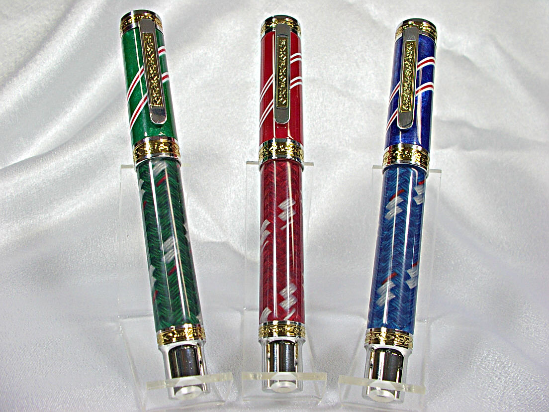

I believe I asked this question but may have missed some answers so will ask again. I do not cast colored blanks much but every once in awhile need to. I have done 3 pens and wanted to cast the caps as close to the color of the nib section as I could with what colors I have. They are not too bad but I know there are those here who do casting could have done much better because they know their colors better. Anyway, my problem is with red. I can not seem to get a pure dark red. I have been trying casting powders. Now they look good in container but when cast and spun down not so much. So twofold question and the first part I probably know the answer and will probably try next time but do you back paint the blanks even though you cast the colors you think work well?? Second question is I am looking for a dark true red color. What do you all recommend. I have tried Black Diamond Scarlet, Black Diamond Candy Apple Red, Coastal scents Celini Red. I have a few others but these are the ones that looked good and closest to red. Exotics has a very low inventory so if you have a favorite source I would be willing to try and please give me name of powder or if you think liquid does better let me know. I am casting in Silmar resin. Also looking for tricks if you have used any to get a deep red. The ones when I spin look more pink or even orange when done. As I said I will try back painting this time too. Thanks for the replys. By the way these blanks will have some segmenting in them but that is not a problem when it comes to colors. The colors I tried had some sparkle in them too which I liked alot.

Tim when I started that thread I was looking to try and match colors for the bottom parts of these pens. I do not cast much colors but wanted to use what I had. So I did wind up mixing a couple reds to get the red shown here. They came out close enough for the ballpark I play in. Good tips though.
