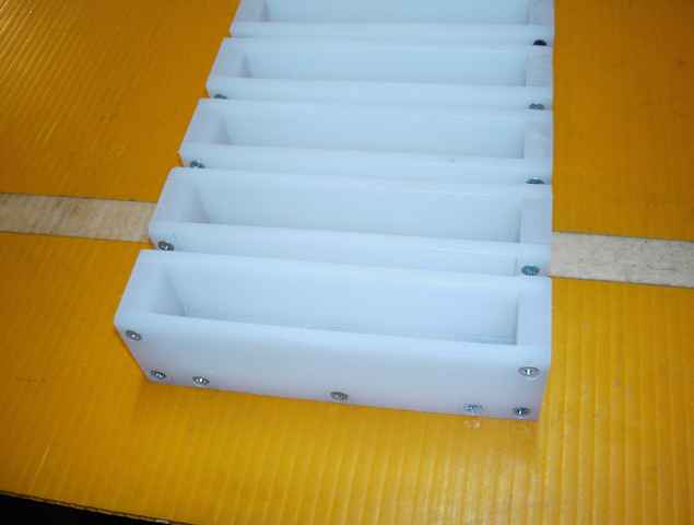

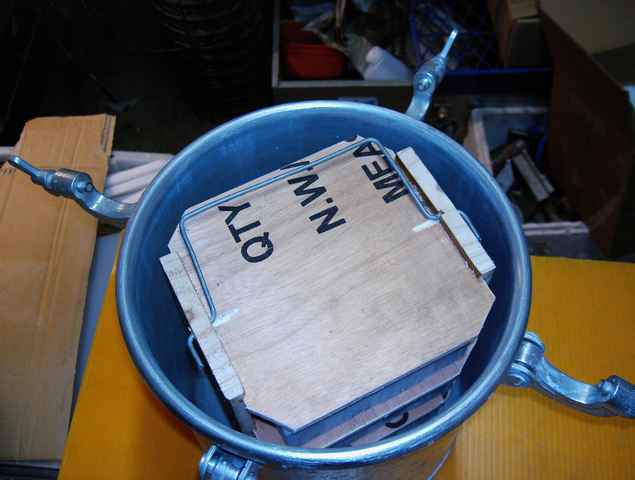

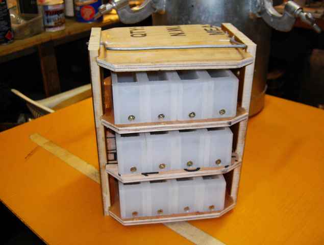

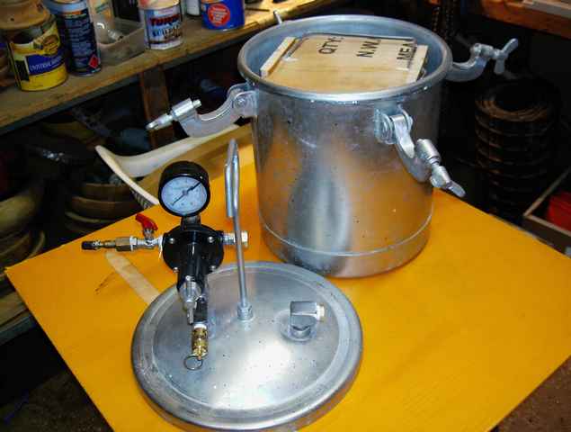

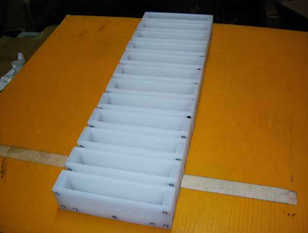

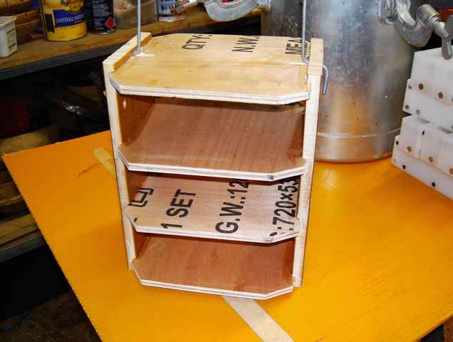

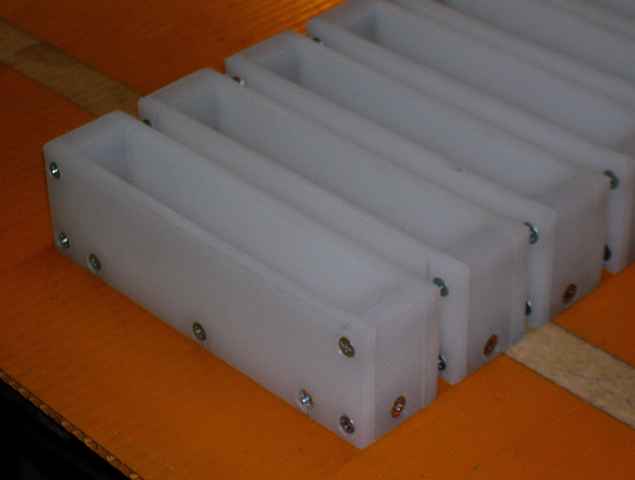

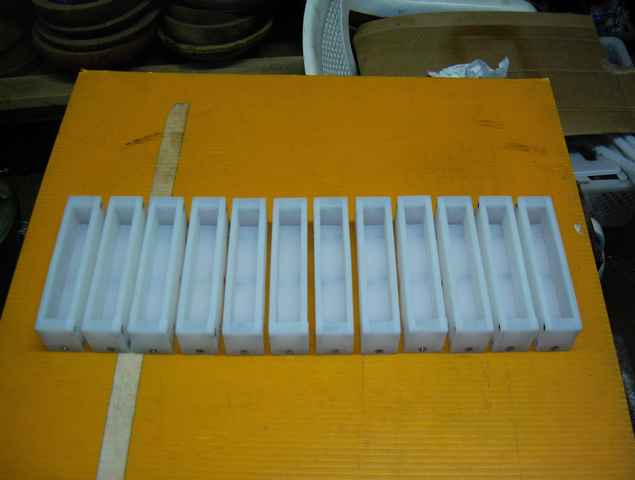

I've been gathering info about this technique, from various sources, including our friend Curtis O. Seebeck, the author of the Worthless Wood Blanks casting PDF files. Been working on getting the gear necessary, as per his PDF file and following his suggestions on what to use and how to make things work, including his suggestion on the type of molds that could be made for this purpose. Got the pressure pot modified for the job, the wood tray for the molds (mine has 3 shelves instead of 2) allowing the casting of 12 molds simultaniastly, made 12 molds, plus cut material for another 8, got the order of the resins, colorants, bits and pieces from the local Adelaide Moulding & Casting Supplies, I'm pretty much ready to start "wasting" stuff for sure, as I know is not going to be right straight a way. So far my expenses are, $120 for the pressure pot, $30 for accessories to make it work as it should, $100 for mold plastics and screws, $200 on chemicals and disposable accessories (gloves, coups, mixing containers, etc, etc.), total of $450 investment to try to save many rare blanks that need something done to them, to make them workable. This casting idea, was what I wanted to try initially, well before I was aware that many other people were already experts on this, never the less, I wouldn't do it if I didn't had the number of timber blanks that are so well suited for this process so, in a few days time, I should feel right to start. I would like to believe that if others manage to get it right, I should too, when? we will find out, huh?

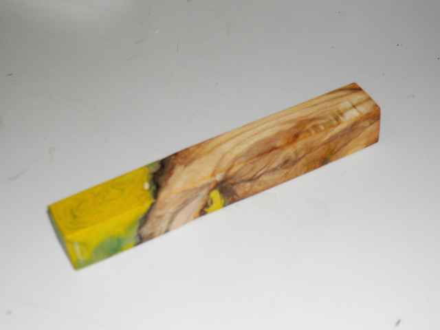

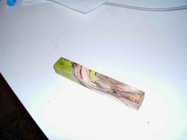

As a point of interest, I purchase 2 types of polyester resins, one called Clear casting resin, the other Quality casting resin, this last one a little cheaper and was my first try, with decision of a percentage of catalyst of about 1.5% for both types, and the first batch was in the pot about 12 hours at 70 PSI, come out pretty hard and no signs on any bubbles anywhere, they were de-molded and let to dry for another 12 hours. Trimmed the excess resins from the timber and they looked OK, for blanks that had only cracks or where only 2/3 of the length necessary, with natural ends and not cut. There is another 12 blanks in the pot at the moment, mixed and put there this afternoon, and these ones are spotted gum burl, just right for this type of casting, this time with the clear resin and colour mix a little more worked on, but when I open the pot after a overnight there, the resin wasn't hard and I could see bubbles forming all over the mold as if was slow boiling, I put it back and closed the pot, giving it another 70 PSI pressure, so it should be interesting. The first 12 I've made were all Majestic Olive with lots of character on the grain!
As I'm typing this post I only have one of the 12 Olive ones I finish this afternoon, with me here at the computer room, so and until the other ones are getting "cooked", this one will do...! I can tell you is doable, but very far from what I would make them look, if I was to continue with this...! which I'm not!

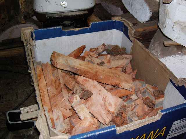

Eventually, pot and molds will be sold, but for now, anyone that wants to try the worthless wood blanks but doesn't have the ideal timbers for the mix, let me know, I've got bags/boxes full, all cleaned stuff.
