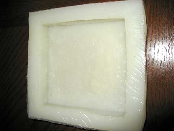

I just took my silicone mold out of the form after 48 hrs. and it's still pretty squishy.... I thought it was acetic cure. It came out of the form ok But it's rather like jello ... is that normal or should it be more rigid?
I may instead try making one out of a cutting board and just plan to make sure to use some form of release agent. Or maybe a trip to the dollar store for some shallow tupperware type dishes?

Heck Lenny nice mold! I see you were more patient than I was, my first mold had a couple of tears and gouges when I tried to free the mold too soon.
Bet you cannot wait for summer now huh!
