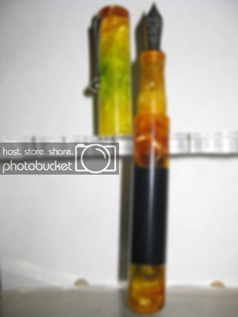

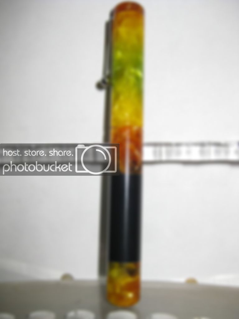

I always throw all of the bits left over into a plastic garbage bin as one never knows what you might need.
I found enough of the same color and some black acrylic tube that I was able to make up this pen. I am calling it The Garbage Bin Pen
Chris
No that's just neat. I like the way the colors transition.
Do you have enough to try another without the black?
You might be able to go right through the spectrum..
The Black
Ok the real reason the black was there as I did not have enough of the other material to do a complete pen. As well I wanted to try threading the black tubing as I am looking at using clear next time and I might try a eye drop filler if I can get the clear tub to work as well as the black one.
