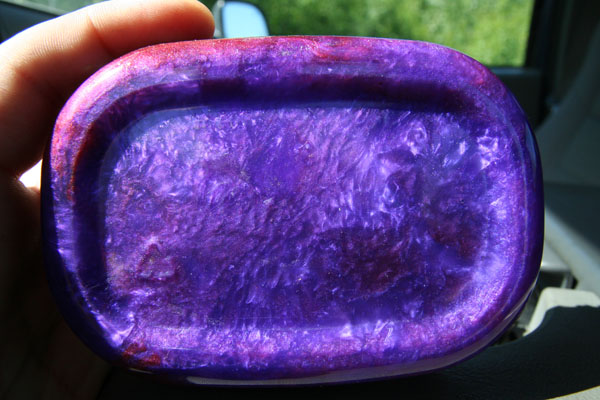

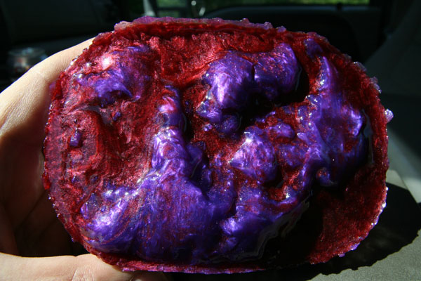

Couple of pics, Tracys first atempt.

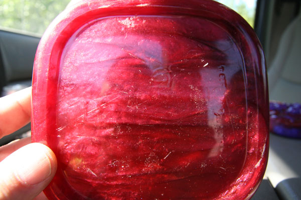

My first go at it. I think this is going to be close to what I had in mind once it is cut and turned?
