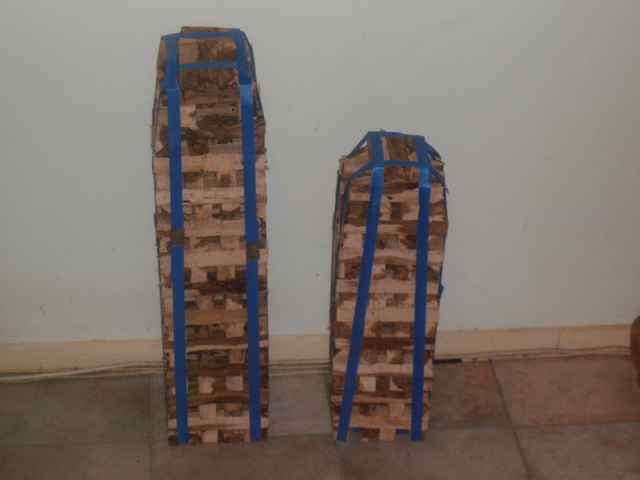

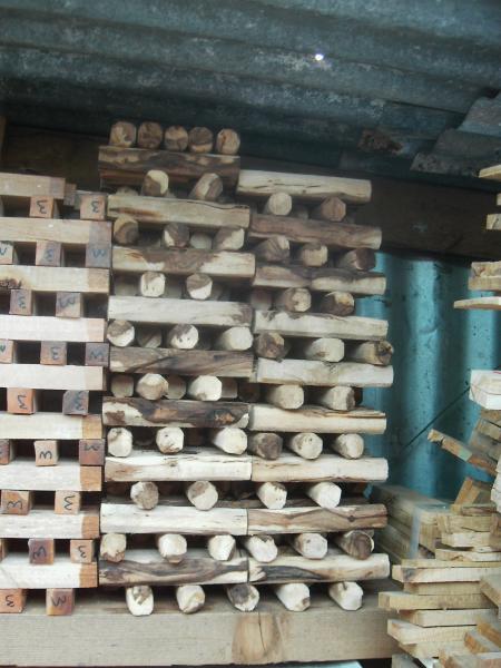

What you should do is to select some logs/pieces that you want to process straight away, those are the pen blanks cut at 1" square and 1/4" longer that the size you want then when dry, after cut stack them as the ones in my pic here PIC08593.jpg or your you take the time to strap them as I did here PIC08431_(1).JPG you can use wire, strong string, anything that has little stretch. One of the big advantages of having them strapped (call then drying towers) is that, if you knock them they will not fall everywhere, making start all over again and, you can always move them from one place to the other without any problems...!
Being strapped also, keep the wood from twisting buckling too much. :wink::biggrin:

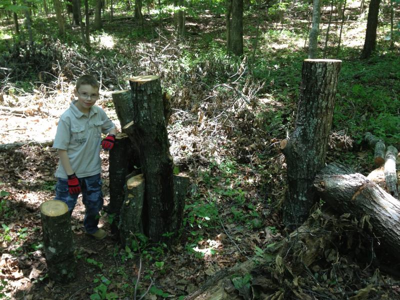

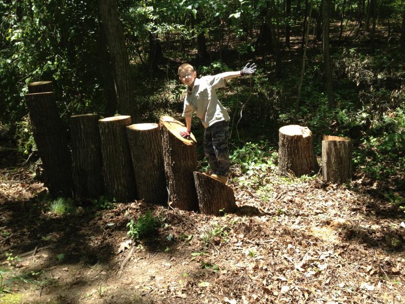

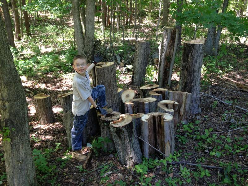

Curtis gave me some advice at the MAPG that to help this wood spalt (and lend it some intrigue since it's otherwise fairly ordinary Virginia oak), to stand the logs up on end on the ground and then cover the tops with dirt and let them stand like that for a while, checking every week or so.
Here's the results of the afternoon's exertions. I still need to give them their "dirt caps", but hey, most are standing up at least. And some of them look to have some interesting crotch grain too... I definitely see some bowls in my future!
