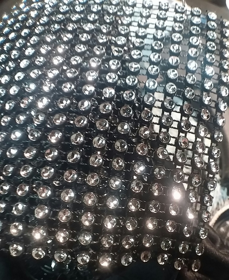

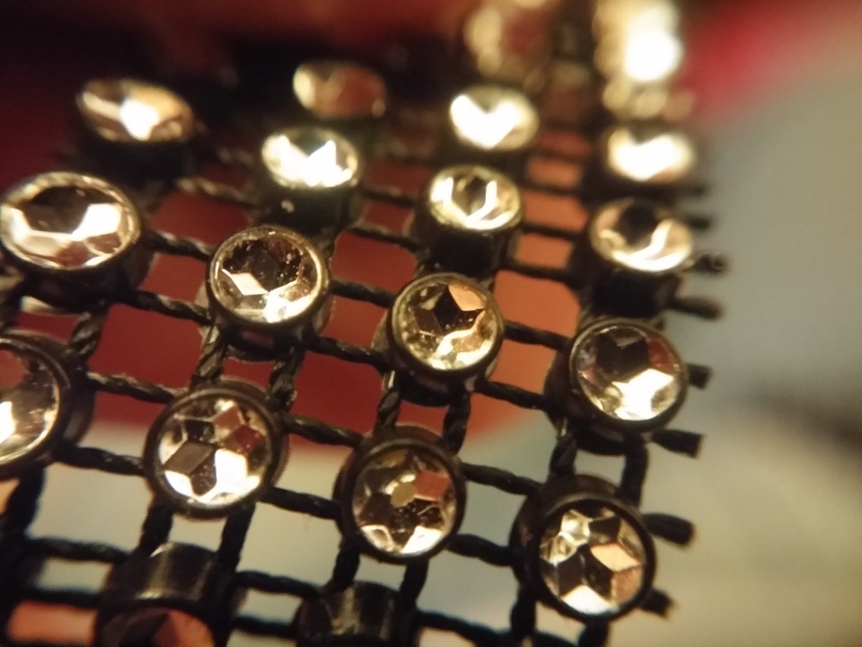

They actually called this Bling.

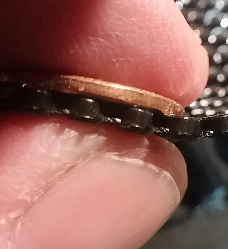

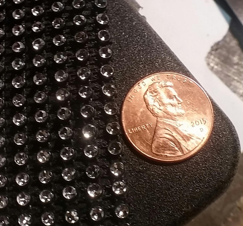

Its a sheet of sequins about the thickness of a penny on a black mesh.
I'll have to see how well it wraps around a black seirra tube. I'll them cast in PR.

Dawn is correct to suggest the Sierra Vista for the component set. I measured the thickness of a penny as 0.055" and the diameter of a Sierra tube at 0.409". A full wrap of your bling will add 0.110" to the diameter of the tube, which means that the pre-casted blank will start at about 0.519". That's larger than the typical diameter of a Sierra component set.
The lower diameter for a Sierra Vista component is about 0.524". As long as you don't cover the entire length of the tube with the bling, you might have enough coverage of the PR so that you don't cut into the bling.

Well not sure right now what they are made of but will check in a few minutes once a can get to the basement. Also I'll mix up an oz of PR and see what it looks like before I attach it to a tube.
Update
Ok tried to figure out what these are made of. Squeezed one with some pliers and nothing. It just kind of squished.
Not plastic not glass, concave plastic sequins pushed into a black cup.
I see two problems, first it's all plastic so may melt and I see those cups just trapping tons of bubbles since I don't use pressure or vacuum.

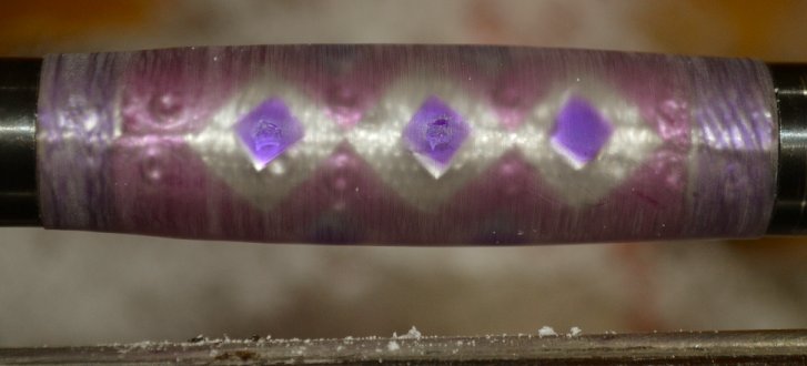

I used the following faux bling in some castings. It's a resin affixed to an adhesive backing.
The thickness of the "bling" is about 0.07", so doubling it added 0.14" onto the diameter of the Sierra tube.

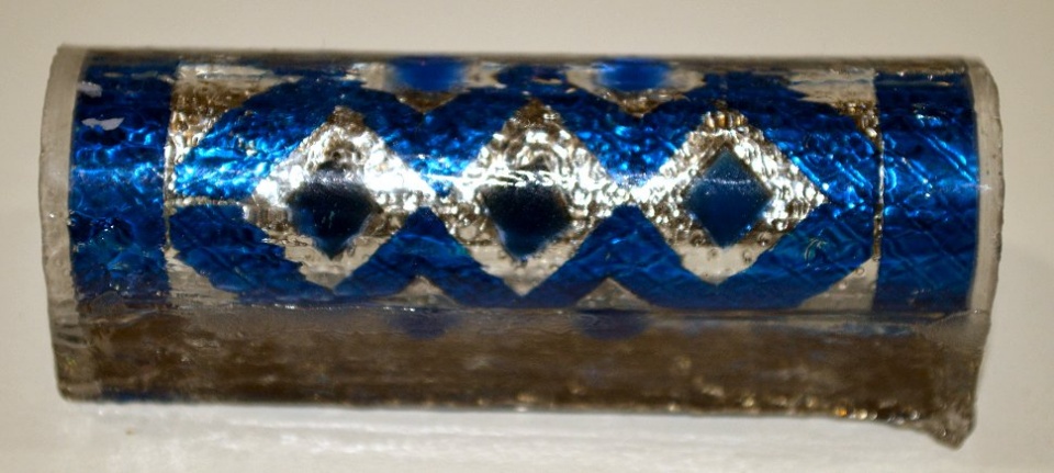

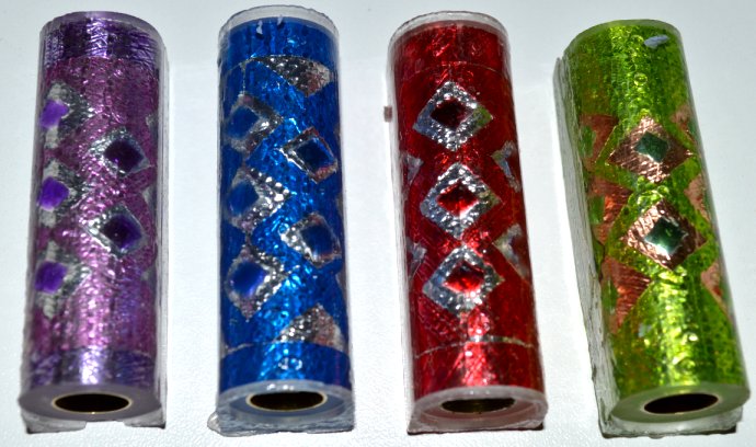

I used HVAC foil, painted with Testor's model paint, and cast in PR to make these:
Here's a closer look at the blue version:
I chose to use the Sierra Vista component, hoping that I could keep a nice barrel shape without cutting into the resin bling.
Fail:
I figured that I would try again, thinking that if I tried keeping the barrel a little larger, I would have success
Fail:

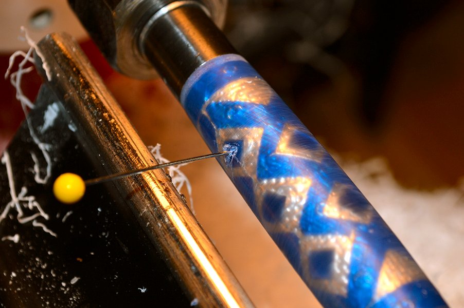

You can see where the resin bling is starting to peek through.
Unless you choose an overly large barrel, you'll likely run into the same problem. This could result in a heavy pen that might not appeal to those that like bling-y pens. Furthermore, the thinness of the PR covering the bling will be fragile and likely crack. I was able to push the pin into the bling and wreck the blank without much effort.
My experience has convinced me to abandon this idea, but you might have better luck.

Did you see my post above? They are not crystals.

Looked like nothing. I guess it didn't help that they really were not crystals but small sequins.
