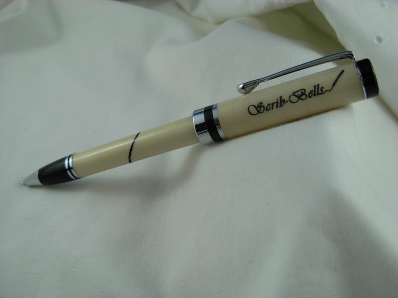

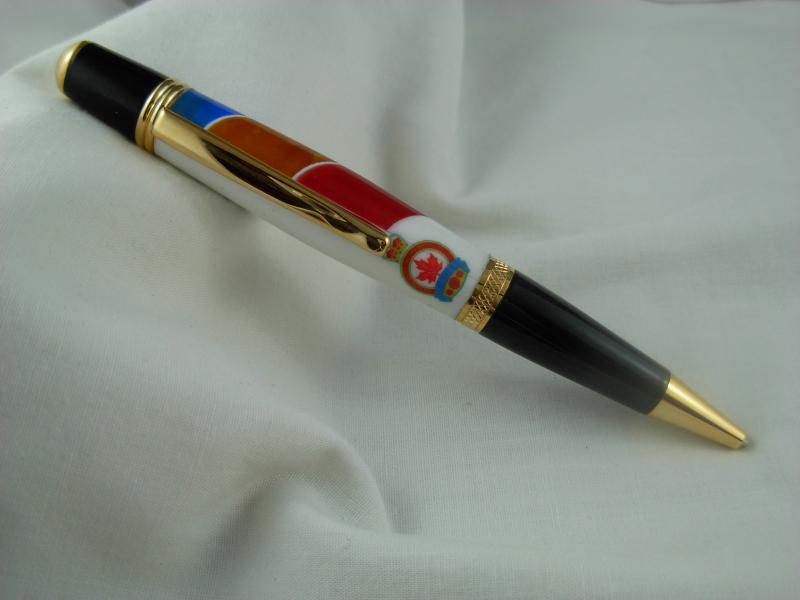

I've been using decals now for a few months. The local hobby store sells blank sheets that I print in my inkjet. After printing I let them sit for a day then I spray them with decal set to give them a little protection during application.
The possibilities are endless. They've actually been one of my better sellers for company logos, charities, etc.
Jeff
Do you just apply CA over the decal?
Yes, but carefully for the first few coats. The first coat I apply in two passes over the decal. Second gets a couple of wipes. After the first couple I apply the CA the way I normally would, about 6 coats.

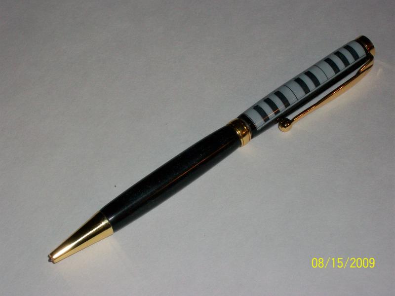

Friend of mine wanted a panio pen without the cost. I used the decal printing kit to make the design. Works real well.
