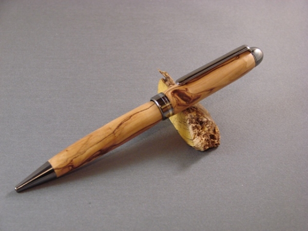

The Euro is my best seller and probably my favorite of all the ball points. (you can tell by looking at the pics in my gallery) I've tried all the platings and the one that stands out is the blk titanium offered by both woodcraft and beartooth woods. The center band is a two tone metal instead of the bold black stripe which I believe takes away from the classy look of the pen. Heres a link to the woodcraft pen.
http://www.woodcraft.com/product.aspx?ProductID=145652&FamilyID=1556
The plating is very durable and I haven't had any complaints from returning customers. It also looks good with a wide variety of woods and acrylics.
For my money and customers this is the best Euro around.
