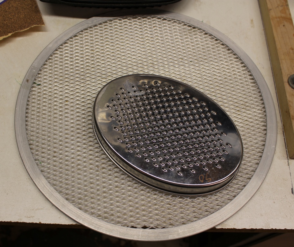

I've used stuff like this - Found in my kitchen... Yea, I know, you're poking through the kitchen stuff has it's risks :tongue:

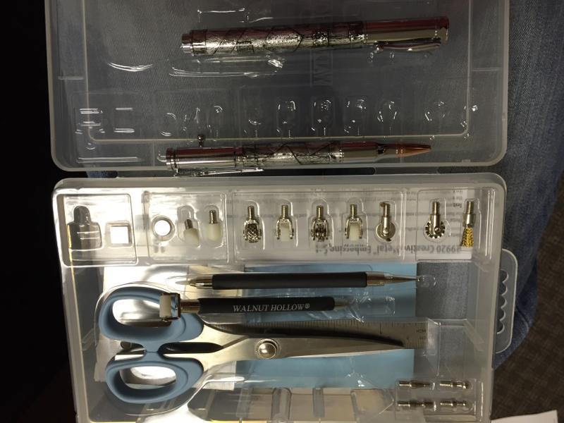

Here is a metal embossing kit that came from hobby lobby that I like.
Do you have a item number for that or what area of the store would I find that?
It's made by Walnut Hollow, item 29920, don't see it on Hobby Lobby's site sorry. I don't remember where in the store it was located, in my local one it was in the main section I go where you see model paints, papers etc but not sure which aisle.

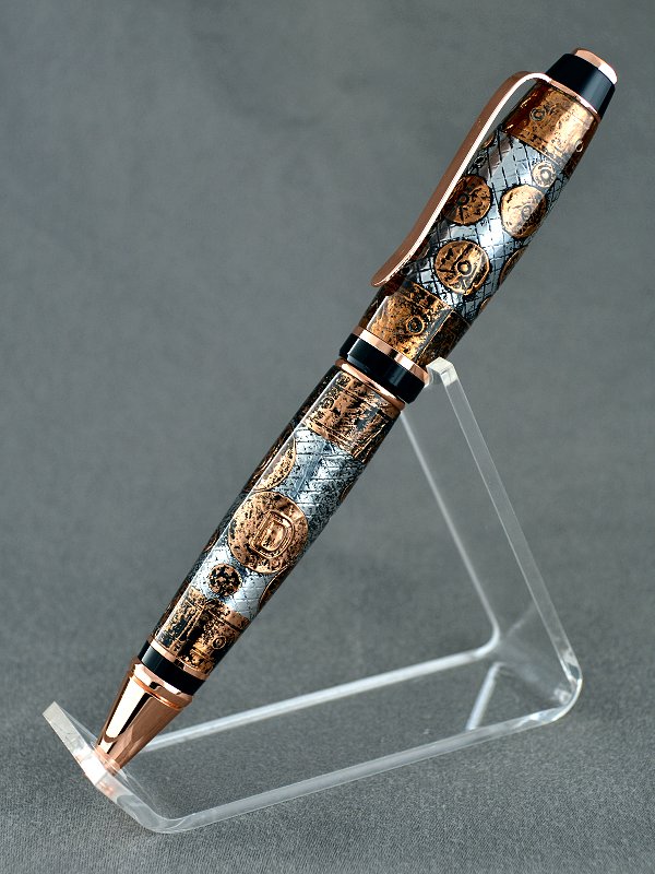

For texturing, I've used a 1/2" threaded bolt on the diagonal to create a diamond plate look. I use a nail set for rivets; I think the pattern tracing wheels look too perfect. I use the knurling on the same nail set for other patterns.
A hollow punch lets you use circles instead of squares and rectangles. You can use a carriage head bolt to create a hammered surface. I also use a leather stamp set for stamping initials.
All of these techniques were used in this pen, which is my current carry pen
