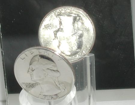

For my NEXT attempt I am going to use the newer nickel you see on the left in
this pic, with the wierd off side head. I'll match that with an old regular
style head for the other side just for a really different looking kind of two
headed nickel.
http://jzcomputer.com/DoubleHeadNickel/TwoNickelStyles.jpg

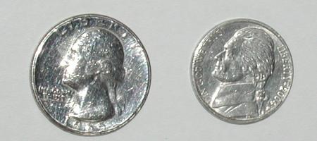

Here you see the "insert" nickel on the left, clearly smaller than the
"hollowed" nickel on the right. As you see in the following pictures, I should
have made the side edge of the hollowed nickel at least .010" - .020" thinner
than I did. Hey its a first attempt! I'll make the side edges thinner next time!
http://jzcomputer.com/DoubleHeadNickel/TwoHeadPieces.jpg
http://jzcomputer.com/DoubleHeadNickel/TwoHeadPieces2.jpg

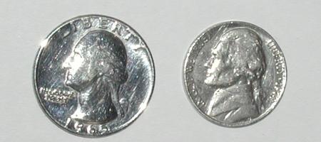

You've probably noticed there is still some super glue visible on the "insert"
nickel, which you can also see in the following two super close ups of the "fake
heads" side (the insert side) of the now two headed nickel:
http://jzcomputer.com/DoubleHeadNickel/NickelFakeSide.jpg
http://jzcomputer.com/DoubleHeadNickel/NickelFakeSide2.jpg
If you look real close at the lettering for "In God We Trust" and such in the
last two pics, you can see I kind of shaved the tops of the letters down a touch
in the process of sizing it down to fit snugly into the "hollowed" nickel. Thats
what I mean when I say I should have gone a fair bit thinner on the side edges
of the "hollowed out" nickel... meaning the "insert" nickel would then be larger
enough in diameter so as not to shave at the letter edges like I did...
But hey, a first attempt using cheap carbide inserts as a practice run to see
what I could get away with while I felt up to playing around a little bit. I'd
say this nickel experiment is enough to settle whether a double headed coin can
be done on a 7x lathe or not, yes?
