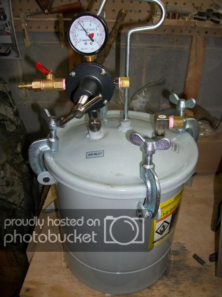

Well after reading everything I could find on the subject I decided to bite the bullet and get the stuff to try some wastewood blanks.After reading all the horror stories of the HF pressure pot blowing I was kind of leary but its all I can afford at the moment so I took a chance and got one.So far so good (knock on wood).I spent the day on sunday putting the pot together and casting a couple blanks.

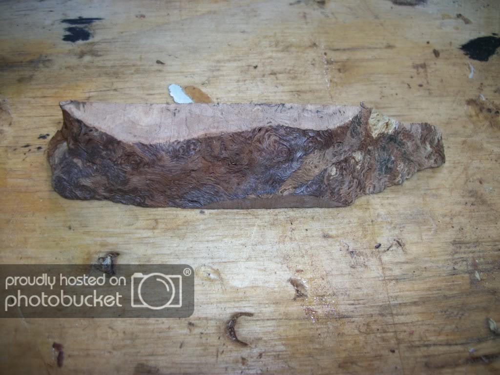

I had this piece of oak burl cap that came from part of an oak burl that was given to me over the weekend.I cleaned it up and got it ready for the mold.

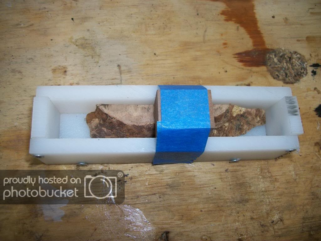

In the mold and ready for resin.I am using Casting Craft PR.The mold is made from a cutting board from Walmart.It cost $2.17 for the cutting board and I got 4 molds from one board.

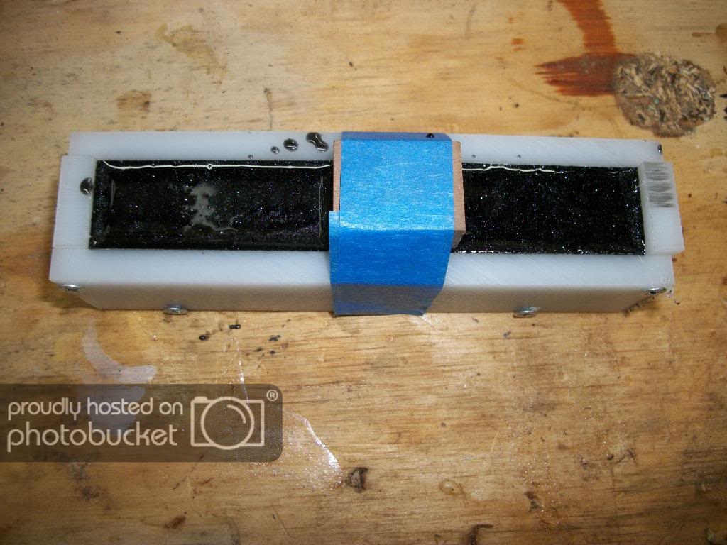

Resin poured and ready for the pressure pot.
In the pressure pot and pressurized to about 38psi.

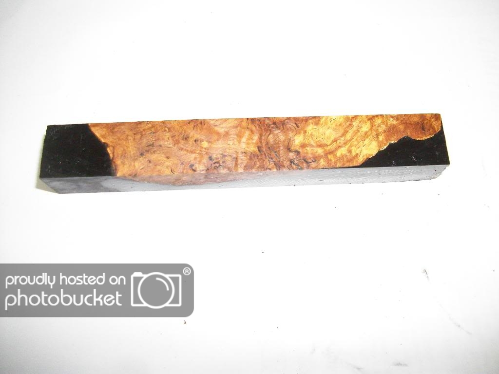

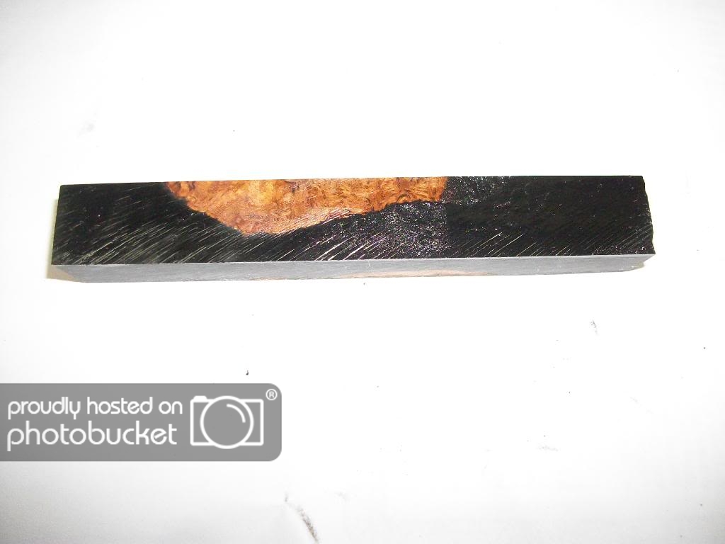

Here it is after coming out of the pot and getting cleaned up on the table saw.Cant wait to turn this into a pen.

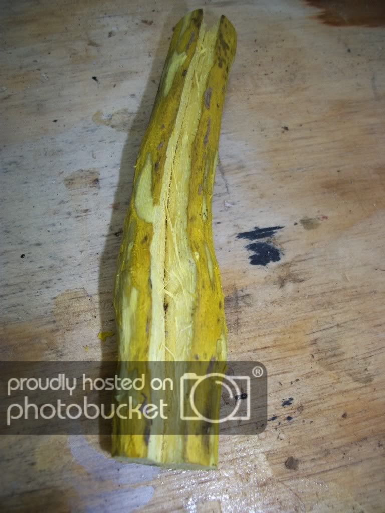

Another piece I done along with the oak burl.I have no idea of what kind of wood it is.Its not Osage Orange.It grows in a bush like Holly does.It is a real bright yellow almost like a highlighter yellow.This was given to me over the weekend as well.

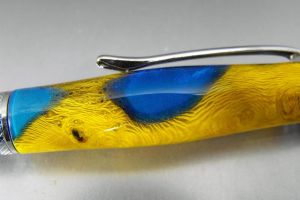

Before

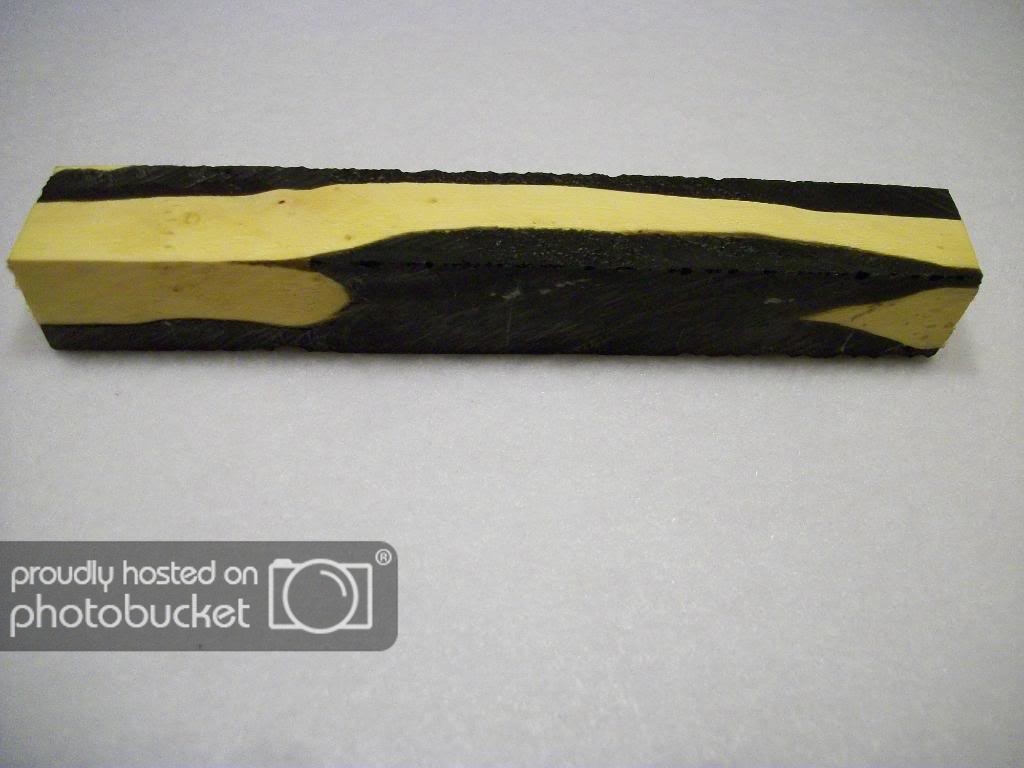

After in black resin.Going to turn this one on a black chrome cigar kit.
