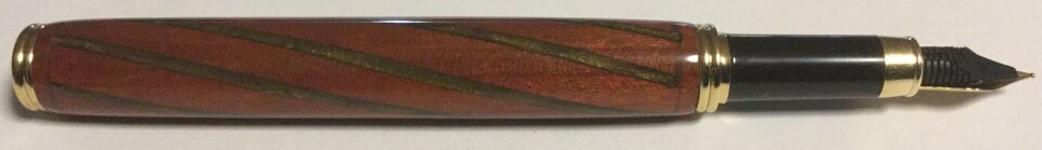

Ok everyone...first attempt at making something with the pen wizard...simple piece of Redheart & using a antique gold pigment in expoxy.
Getting the expoxy fill was a very messy experience...so after some advice on how to make it easier and not so messy.
This was just a throw away job to see if I could do it...

Looks very attractive, Nicole !!! What is the pen kit ?
How did you apply the gold epoxy fill ..... with a toothpick or similar ??

It's just a cheap fountain pen kit. I haven't done the cap yet. It was just a trial run :)
Applying the expoxy was another story! Used a flat head screwdriver like a spatula to fill whilst I had it on the lathe to turn.
Have tasked the hubby with making me a jig up for putting them on to turn & set.
Nicole,
Can you tell me the name of the kit, if possible, please ... the reason I am curious is that I don't see any threads for the cap to screw onto. So I am thinking it is a snap on cap and I haven't seen any fountain pen kits like that before. Thanks.
Sounds like it was a lengthy task applying the gold-filled epoxy with a screwdriver ! The result looks remarkably good !!

Hi Mal
Yes it is a snap on cap. The kit was just called "Fountain Pen". I brought a pack of 10 for $25 (they were on a clearance) from Carbatec here in Perth when I first started to give me something "cheap" to play around with whilst I was learning. They have a good size section on them to work with on the wizard.
I used a CA finish with a couple of coats of the thicker CA to fill in a few bubble holes from the epoxy. :)
