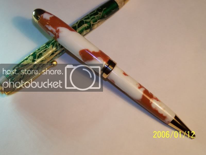

Amen to that! I've got a large flat rate box just overflowing with messed up blanks. Either the colors didn't swirl, or bled together, or one color gelled too fast and I have a blob in the middle of the other color...I could go on and on. I like to give them away to turners that are new and haven't turned PR or acrylic blanks so they can get a feel for how to drill and turn without worrying about blowing them up. They'll save $ not destroying the blanks they paid good money for.
... or one color gelled too fast and I have a blob in the middle of the other color...
I've found that if you use a couple of craft sticks as a scissors to cut up the thickened glob of PR, and distribute the smaller globs throughout the mold, you can end up with some pretty nice blanks. I was originally trying to make a swirl pattern using UT colors. I think I like the mistake better. Now I do it on purpose.
