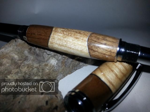

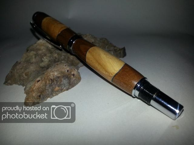

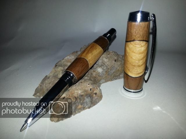

I took the lessons learned from my last segmenting effort and applied them here and I like the result far better.
For this one I took a piece of walnut and cut 1 inch holes in it. I then used a plug cutter to cut one inch pieces of oak. I wrapped the oak in aluminum and glued the plugs into the walnut and then cut and worked the blanks as per normal.
Here is the resulting Jr Gent. I will definitely go this route again, except next time with nicer wood. The only flaw that I can see is that I forgot to orient the grain in the plugs so they are different by about ninety degrees. If I were microsoft I would call this a feature.

Mike, this is so simple it is brilliant. One question. When wrapping the aluminum, how do you hide the seam where the edges meet?
I didn't have to worry about hiding the seam because the plugs were one inch and the blank ended up as 3/4 so I just made sure that the seam was on the outside part that would be cut/turned off anyway. I'll take pics next time, and rest assured there will be a next time.
