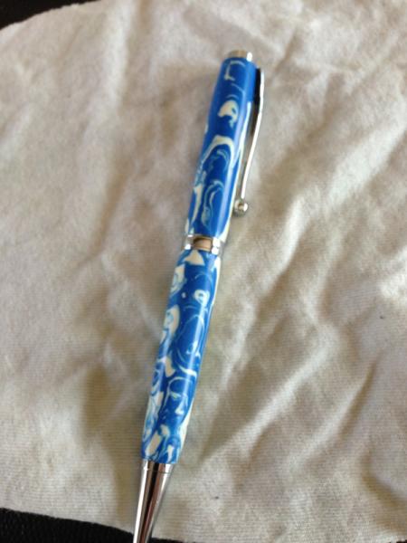

I made a slim with the blank. I didn't see any bubbles after turning. Picture later although just a 2 color test.

This is the photo of the pen.

I didn't get a chance to get back to this thread until now. The blank was better with the pressure. I used a plain 4 slot resin saver mold. The blank had tiny bubbles that were pushing out at the sides. There were none on the top or the bottom. Once I turned the blank and finished the pen there was no sign of any bubbles at all. The first blank that I did without pressure had quite a few very tiny bubbles throughout the blank.. The pressure seemed to resolve that issue.
I was mixing fast and I probably could have stirred it a little bit more. The white color had a few amber streaks I assume from not fully mixing. The blue was not perfect either probably
for the same reason. I was
more intent on getting it pressurized before it set up.My next test I am going to use some of my PR dyes.
