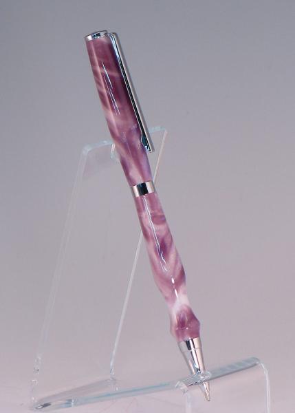

This is the PR. Pen is a Chrome Slimline using two white painted brass tubes.
PR and Flat Mold Observations:
Slow to cure - accelerated with toaster oven
Easy to mix and use
Accepted the Alumilite dyes OK
Easy material to turn, may be a little brittle but nothing dramatic
Makes long curlies that break up by them selves
Polishes to a brilliant glassy shine
PR has an extreme odor
Mold is easy see how the mixture is "swirling"
Mold is easy to use
Mold is rather wasteful being it makes square blanks

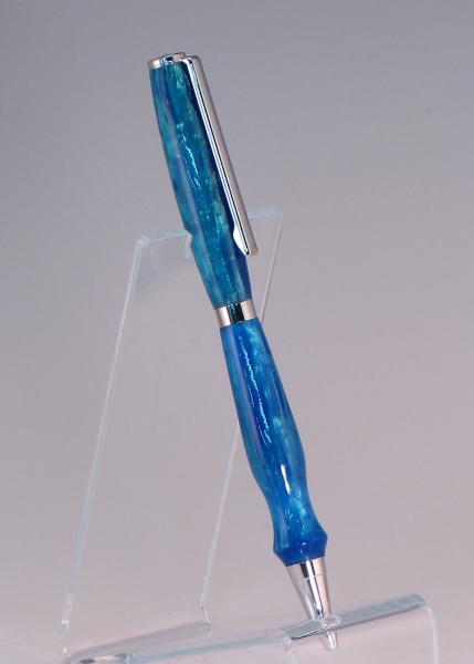

This is the Alumilite. Pen is a Chrome Slimline using one white brass tube(bottom) and one unpainted brass tube(top). The top looks a little brassy in person. There is just barely a hint of it in the photo.
Faster to cure
Easy to mix and use
Lots of compatible dyes available
Very easy to turn, could detect no brittle ness
Makes "overly" long and tough curlies requiring frequent stoping and clearing.
Does not shine up like PR. Coated it with CA to get a shine.
Alumilite is pretty much odorless
Mold is easy to use but not very visible
Mold uses less resin
Mold is one shot use with Alumilite due to no shrinkage of resin.
Blank had many pin holes due to unpressurized curing.

I like the PR overall results best. UMMV
