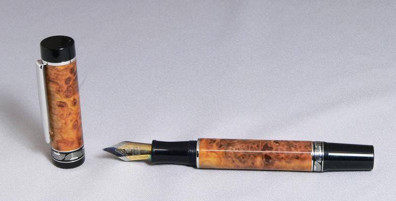

I use fountain pens almost exclusively, and the only kits I like to write with for any length of time are the Churchill or El Grande from Berea. The reason for this is that they have less metal in them, so are lighter and better balanced, and they have a nice fat section (part you grip when writing). None of the kits balance with the caps posted, including the ones I just mentioned. Berea nibs are questionable at best, I substitute a Heritance nib. Obviously others will disagree with me on this, but JMHO.
Here is a pic of one, actually it's a Ligero, no longer in production from CSUSA, but looks the same as the El Grande, with slightly different bands.

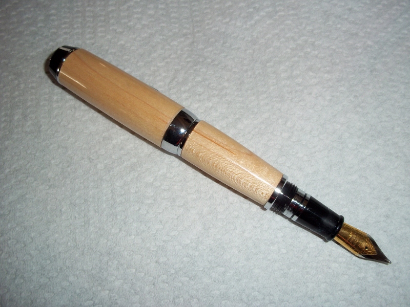

so the kit i had was an el toro, decided to turn it this weekend. didn't really want to but was in desperate need of some workshop time. this pen needs 2 odd ball size bits that i will never use again so i drilled it out smaller then turned the inside larger in my chuck. quite the task. didn't want to ruin a good blank so i used a scrap piece of maple. then forgot to turn the tenon on the lid for the large ring so had to remount the finished lid to turn it down. and to think, i know what i'm doing. but i was right. i don't like the kit. but didn't turn out bad after all that. will definitely try another kit soon.
