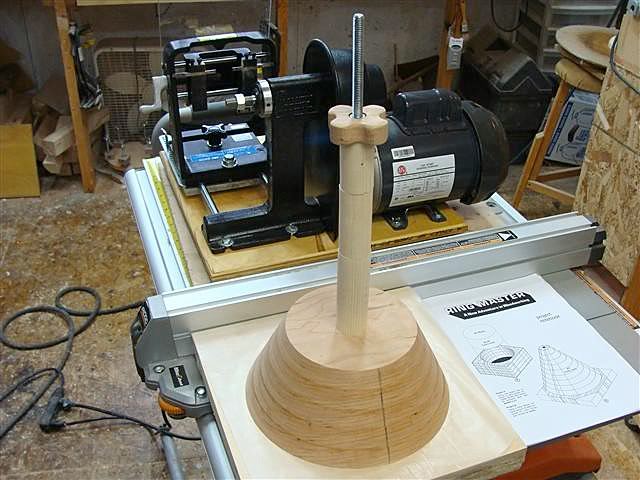

Had a cherry board with a bit of figure in it .It was 10" wide so I cut 10" off of it . Drew a circle on the wood with a compass and cut off the corners. Drilled a hole on the center and put it on the ringmaster. Cut the rings and glued and clamped them as shown
Exactly 1 hour and five minutes from start to finish and wasn't hurrying . This is the closest I have come to the rings matching with each other . I think this is about as good as it gets for accuracy in cutting the rings.
Should not take any more than about 5 minutes to sand both inside and outside of this one before applying sealer and finish.
I will let the glue dry overnight on this one instead of rushing it and sanding after a few hours like I did on previous ones.
The pencil line is my alignment marks for keeping the grain alignment as original on the board.
This is how it works out when paying proper attention to the trigonometry . The darker lines around each ring is just due to the wet glue not cured when taking the picture . As a dry fit before gluing , each ring blended in to each other as the same color and will again when it is dry. .
