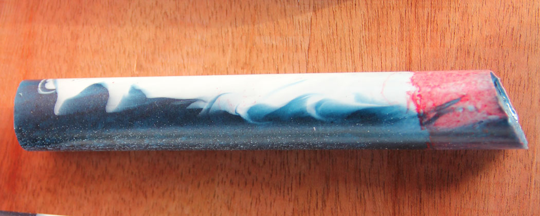

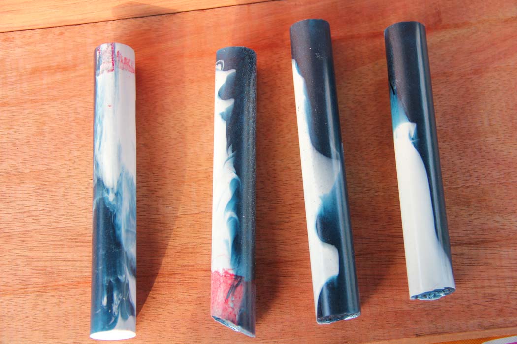

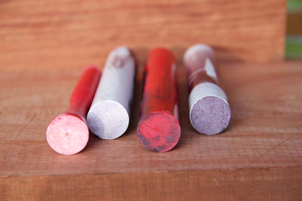

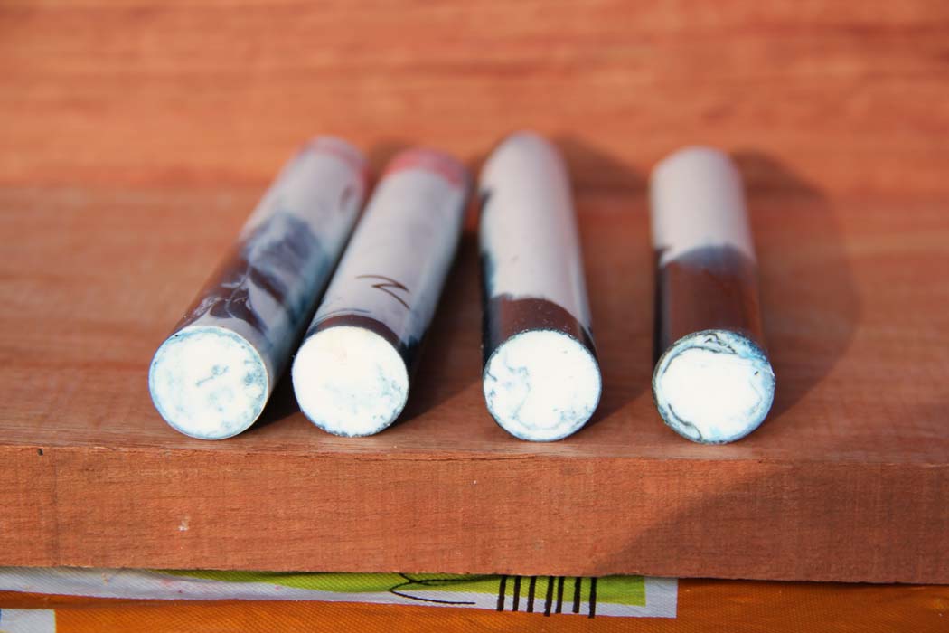

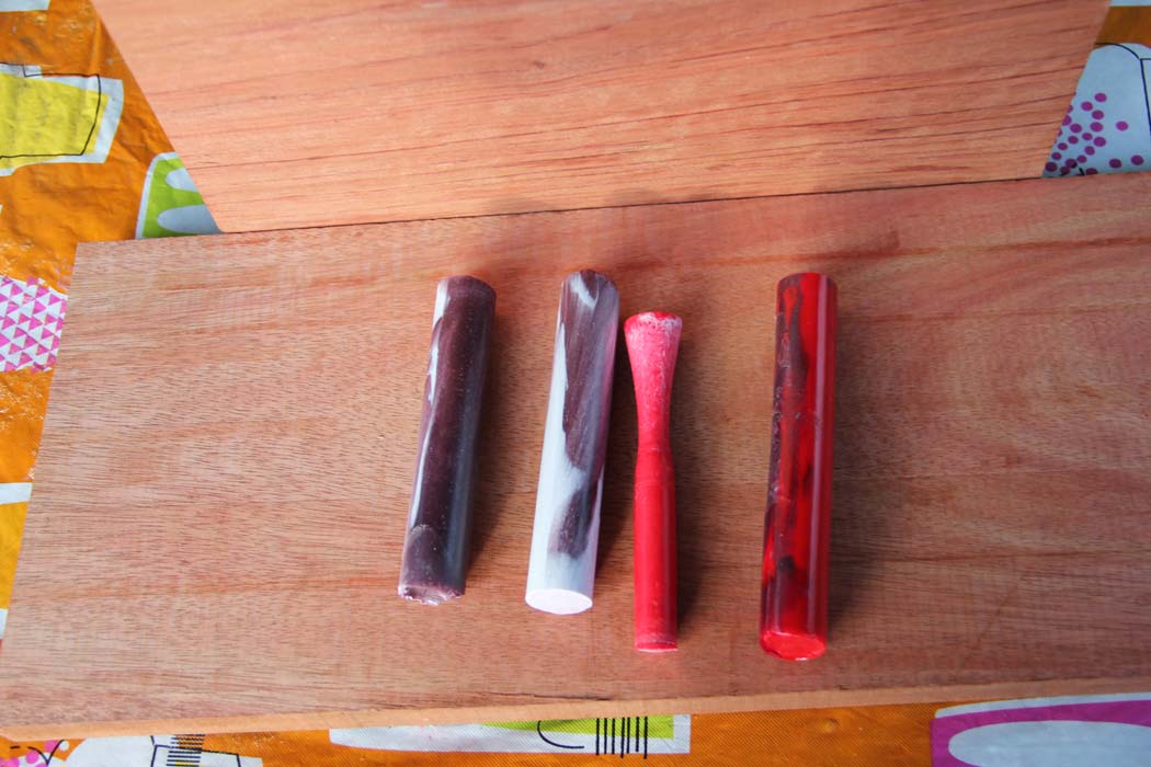

So this last week I cast my first set of PR blanks. I used casting craft from michaels in a pressure pot and under shot on the catalyst on the first set but second time got it better.
First pours
So I had some time to turn down a test one and found that my white and red has totally mixed too much. Is this happening due to the short amount of catalyst? or do I need to wait to have it thicken up more? Could it possibly be because the white is settling to bottom of the vertical tube before it hardens enough?
Second pours

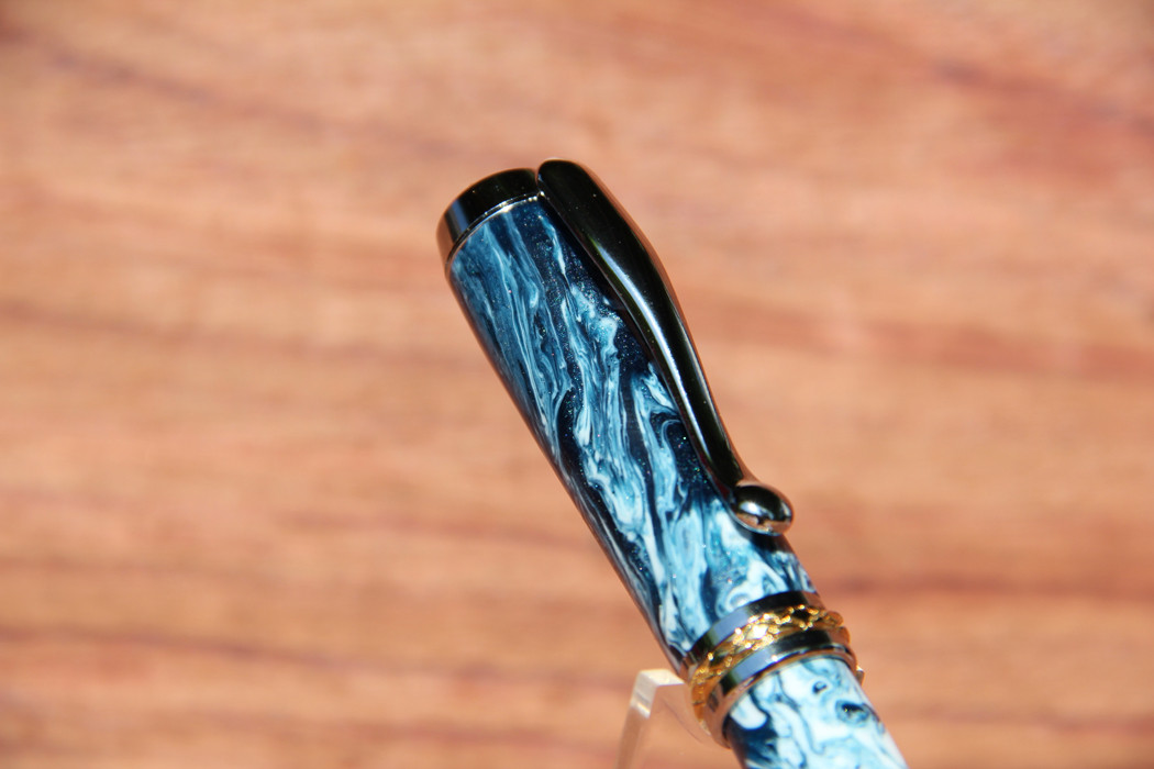

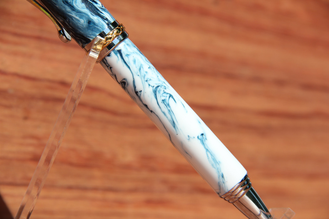

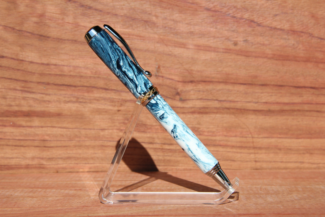

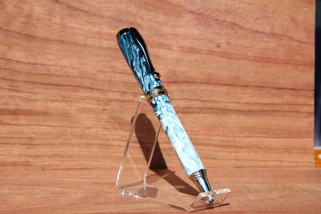

I am going to try and tube up one of these blue and white ones and make a pen from my first casts to hold onto so in a year I can laugh about it.
On the red & white, it looks like you used dye for both colors. The opaque dyes seem to take longer to set up. So make sure that one of your colors is close to setting up before you pour. As far as colors settling, that's going to happen in almost all cases. The pigments we add are all different weights. So some will almost always sink. But if you pour close to the time the resin gels, then it will be minimized.
I think your 2nd pours look pretty good. If you have good color separation on the outside of the blank, then usually it just gets better on the inside. In fact, I'll bet the maroon & white in the 1st cast will be fine too. You just won't know till you turn off about 1/8"
Some guy once told me it takes about a gallon of casting to get a good feel for what you are doing. He was right on the money. He goes by Brooks8 . . . . something. You may see his work around here if you look hard enough.:rolleyes:

I used dry pigments. I wasn't sure how much to use but I recorded what I did use if I need to add more or less. I really would like to get some depth in the blank so I may use less pigment next time.
yeah I'm figured the first 7-8 pours would all be experiments and getting my system down.
I do think I need to wait for one to set up more so it wont blend. is it better to have one thin and one thicker or is both thick ok? I tested out a couple different wire shapes for blending on the blue and white pours so I think ill see how those turn out.

If you want depth, use transparent dye, or pearl pigments. Less pigment will just give a washed out look once the material is turned for a pen. Transparent dye will require reverse painting. And most people that I talk to don't really want to do that. But you can get some really spectacular pens with transparent dye, or even clear resin with the right color(s) back painted on the blank.
Both thick is ok. Just watch both of them. As soon as 1 starts to thicken, you're ready to pour. And I wish it was really as simple as that, but that's only a general rule. For example, I use a lot of opaque white dye. It starts to thicken a bit faster than other colors, but then it doesn't set up as fast as most pearl powders.

I think you did great on that 1st pen from your own cast. I don't think you'll laugh at it in a year. Yeah, I think you're hooked.
