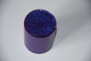

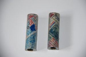

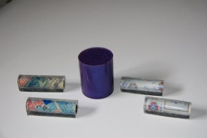

My first casting ever, with HF ultrasonic casting and scroll saw vibration. Casting pr is mass clear casting resin gel, the bottle stopper was done in a pill bottle and used 688 misty lavender pearl-ex powder it is much more purple than the picture shows. Just recieved my 6 bottlestopper mold from the penwizard :biggrin: cant wait to pour it.

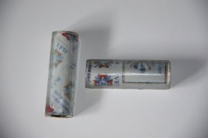

Not sure why the VFW faded but not all of them. I glued to tube with glue stick let dry and then coated with modge poge then poured. Just surprised that they all did not fade. The ones at the end seemed to maintain their color.
All comments welcome, here to learn.
Thanks in advance and I will post as soon as I turn them.
The pens will be for a silent auction to benifit the Honor Flight of Northern Colorado in Ault Colorado. You can check out the program here: www.honorflightnortherncolorado.org.
Hopefully the next castings will retain the color on the VFW stickers.

Ed:
I know others here get great results with Mod Podge. I am NOT one of those people! Every time I use Mod Podge as a clear coat, I get results similar to your VFW cast.
I just changed over to 3 coats of thin CA. I've been very lucky with that proceedure.
YMMV!
I guess I am glad it was not just my technique. (sorry it happened to you too) Odd tht they all did not fade only some. I'm going to try doing the VFW ones again and maybe letting the Modge dry for three days and see if that gives a better result. Haven't got the courage up to do CA on a spinning lathe yet.
Ed

Ed,
Sometimes PR will soak the stamps and cause a color change. I have done like Andy and started putting CA layers on my stamps before I cast them. This has stopped the color/cloudy change to the PR on my castings.
You may want to give it a try and see if it changes your results.
Looking at your results again. Is the cloudiness in the resin or did the stamps actually fade? If it is resin cloudiness, it could be caused from the water based Modge Podge. Water and resin don't mix and if you didn't let the glue dry enough, it can cause cloudiness.
Give it a turn and see if it goes away....
Thanks fred I will give it a try. This time I will leave the Modge dry for a few days instead of just overnight. The cloudiness is the sticker not in the PR it is very clear. The VFW ones were acturally return mail stickers. The stamps are just old not near as bright as modern stamps. But I plan on giving it another try this weekend. I will post the out come.

Go to your local home improvement or craft store and pick up some 1/2 inch dowels. Cut them into about 6 inch segments and mount between centers. That way you can practice putting CA on to seal stamps or to use as a finish without having to worry about messing up something valuable. Good luck!
