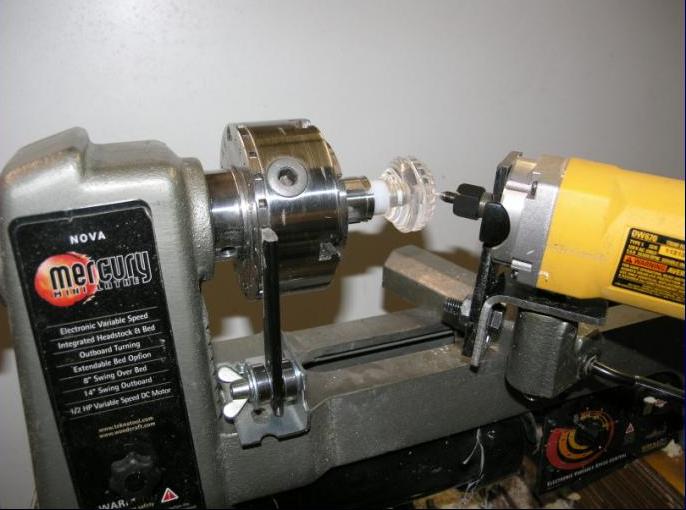

First, what did you use to cut those? A rose engine?

I would also like to know how this was done. I really don't think I'm up to the task (don't even have a router yet, have a dremel tool though), but I would still like to see. :)

Do you have photos of your set-up that you would be willing to share or this would be a topic for a tutorial..
This is version 1.0 and I will be making some changes to it. Basically you just index the blank and rotate the router to make the cut. A tutorial covering all the possilities woud be difficult and would depend on what equipment each user would have available to make the parts etc.
Hope the photo is helpful.

Not asking for trade secrets, and I'm surely not up to the task using a router, but curiosity is driving me bonkers wondering if you are using a straight trim bit or something fancier.

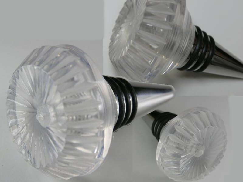

That is a really nice job on the stopper by the way..!
Looks like a v-groove bit to me. The indexing is interesting on that lathe..I haven't seen indexing in that style. Mine is a pin behind the drive head. I had a feeling that's what you did...great work!
Jeff and John,
The bit in the photo is a V. I used that and a bull nose on the stopper in the picture. A straight bit could be used along with just about any other bit.
Many designs can be made using two bit with all the different angles, depths, overlaps, concave, convex cuts etc. Lots of possibilities.

Chuck- those are really neet, remind me of the old glass door handles from years ago. Is the much sanding after the routering? I've got 4 routers, & might someday set something like that up. Using that setup I can see where it would cut the concave. Always making an arc with low spot at center. But do you somehow move the banjo to make a convex? Be kinda hard to control I'd imagine. Unless that's just one of your setups in the pic. Can't imagine a router bit moving slowly could leave it that smooth. Somewhere I saw a jig similiar to that that would cut a perfrec ball. It reminded me of an idler arm on a vehicle. Thanks
