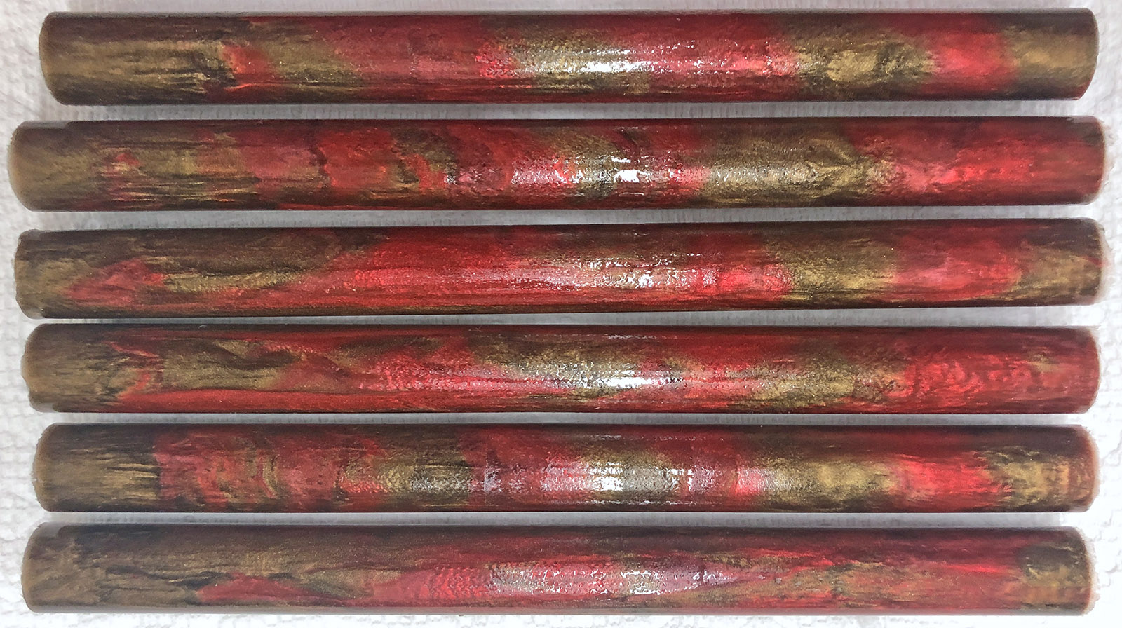

I tried out a new Schedule 80 PVC mold that I made yesterday. The blanks are between 8.5" and 8.75" inches in length depending on shrinkage during pressure curing. Here are the details of the cast:
Name: Ruddy Brown -- As a solid color, Ruddy Brown would be considered a reddish-brown that is reminiscent of the color of Mahogany wood.
Resin: Alumilite Clear Slow
Volume: 476 grams (79 grams per blank)
Recipe: Eye Candy Bushido Brown, 45% of the volume
Eye Candy Rusty, 35% of the volume
Eye Candy Senshi Red, 20% of the volume
Method: Standard Rotation of the colors starting with Brown, 4 to 5 cycles
Cure: 55 PSI at about 15 minutes after mixing (about 4 hours before demolding)
Considering the vertical mold and the way that I pour I think the colors always look more blotchy on the outside of the blanks. I think it is a relatively common artifact because of how the resin clings to the sides of the mold tubes as they are being poured in. I've found that there is usually a lot nicer swirling on the inside even though I do not use any kind of skewer, wire, or other stir stick after pouring.
The Eye Candy Rusty was a lot more vibrant and a little more heavy on the red side than I was expectiong. I thought it would be more of a copper-ish color. I also think that is why the reds look much more pronounced in the picture. Overall I like this color combination and I will probably make up a pen before the end of the weekend to get a better idea of how the red and brown swirled together on the inside.

Looks like you will have enough blanks to keep you busy, they look good. Also would like to see finished product.
I pour vertically in both silicone molds and in PVC pipe - both work great, but the results are a bit unexpected because as you say, the resin sticks to the walls of the mold and the outside looks much different than the inside on both molds. My first batch I though the colors looked really awful when I first looked at the rods - blotchy, no swirl, and badly blended, so I gave a few away to turning friends to use for trial runs on new designs. About a week later one of my friends showed me this utterly amazing pen - with a blank that was really pretty incredible. He then pulled out a small piece of the rod that I had given him and he proceeded to tell me that the pen came from that blank! I was stunned. Lesson learned.......now I try to turn down a piece of each rod to see what I have beyond the outer skin, and more times than not, it looks way different. Both the silicone molds and the PVC pipe do the same thing, with or without mold release spray.

I've reduced the number of blanks I pour in a batch to 3. This way if I don't like the color, I don't have too many, and also 3 is about the max I can pour carefully once the temperature is reached. I wait until 100 degrees and the consistency thickens from milk to Elmer's glue. Then I get better patterns and swirls. The last one I pour is always the best of the batch (thickest consistency).
