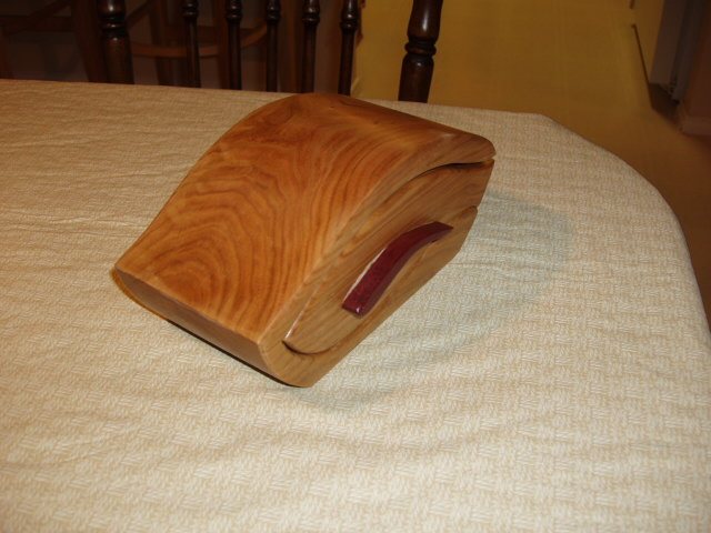

I recently took a class at Woodcraft learning how to make Band Saw Boxes. I really enjoyed it and they are NOT as difficut as they appear to be. I do need to go get a 3/16" blade to do tighter cuts on my own band saw though..... Maybe even a 1/8", but there would be at least two blade changes per box required to do so...[:I]
Here is a Butternut box with a Purple Heart handle. I started out a a solid block. I finished it with Polyurethane. I might try waxing it to really bring out a shine, but am undecided right now....

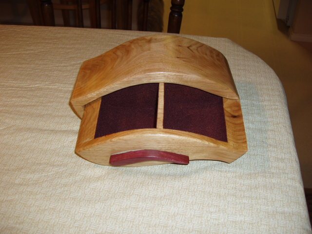

The inside of the drawers is lined with Wine-Suede Flocking, which is really easy to do. Make sure you have good ventilatin for the adhesive though....[xx(]
nice work bob, i've been wanting to build one of those for a while! they do seem pretty easy... did you saw out the drawer shape, then cut the front and back pieces off, then hollow out the drawer area?
Thanks for the comments!! It was a fun project and I have another sitting 1/2 finished in the shop right now. The pattern was given to us in class. We were sitting there wonderng how we would use a contrasting piece of wood for the handle and I remembered that I had purchased a bag of purple heart pen blanks for an order, so I resaw'd three blanks for the class.
To make one, you must make sure the block is square (90 degree sides), then resaw 1/4" off the intended back side and set it aside.
Attach your pattern to the intended front with spray adhesive and cut the drawer body out of the center and set it aside.
Glue the 1/4" slice to the remaining main block. It will be an "almost" invisible glue up. Set it aside to dry.
Cut 1/4" off the back for the drawer block and 1/2" off of the front and set aside.
Cut the drawer hollows out of the remaining block.
Glue the drawer front and back to the hollowed block and set aside.
Cut the outside of the box from the original block that the back was glued to.
Now you have a LOT of sanding to do!!! Both machine and hand sanding is required.
Once all smooth and pretty, sand some more because you WILL find the need....
Cut a handle out of what ever you want of cut/sand a way to pull the drawer out.
Finish with your choice of finish.
We used two band saws in class since it took a a 1/2" 3 tpi blade to resaw and 3/16" 8 tpi for cutting the curves. I imagine it can all be done with a 3/16" blade to avoid changing it....
